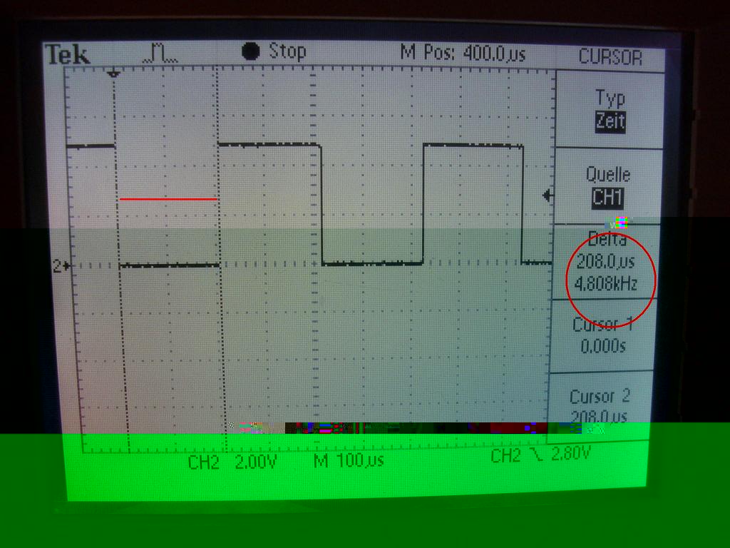

Re: UART recieve value allways zero
Hello!
I´ve checked that pulse see picture below. Also i have changed the 20Mhz Xtal to another 20Mhz Xtal. No solution!
So the scope will be ok. What next? Perhaps i will change the PLL, but this i often used well.
