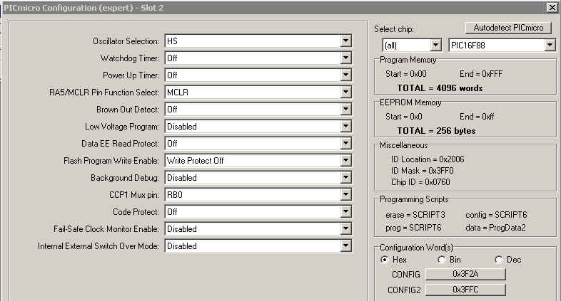

The example "Interrupt every second" will not run exact in simulation and at the EB-06.
Simulation: if I change the prescaler rate from 1:256 to 1:16 the LEDs increase in about 1 sec. interval.
EB-06: no action, only LED D0 is lighting constant.
Is my configuration correct? Please look to "PICmicro-Configuration.jpg"
Chip-Freuquency: 19.6608MHz
I have no idea where I have to debug.

Hello Rabbit,
In your timer interrupt properties please ensure you are selecting the clock source as the CLKI and not the External Input. The timer should then run correctly on the hardware. The simulation speed will probably not be exact but allows you to see how the program should work when it is running at the correct speed on the hardware.
Re: Problem with interrupt timer
Hello Ben,
You got it! Many thanks to you. The internal clock (CLKO) is it. Now the program running with correct speed on the hardware.
Only the simulation is very slow.
Many thanks and best regards from Rabbit
