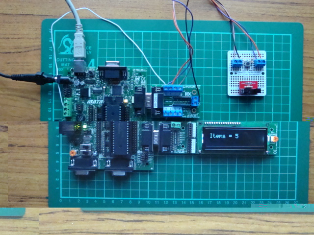

Equipment :
EB006 Programmer – Standard configuration with PIC 16F877A
EB002 - Screw Terminal Board
EB 005 - LCD Display Board

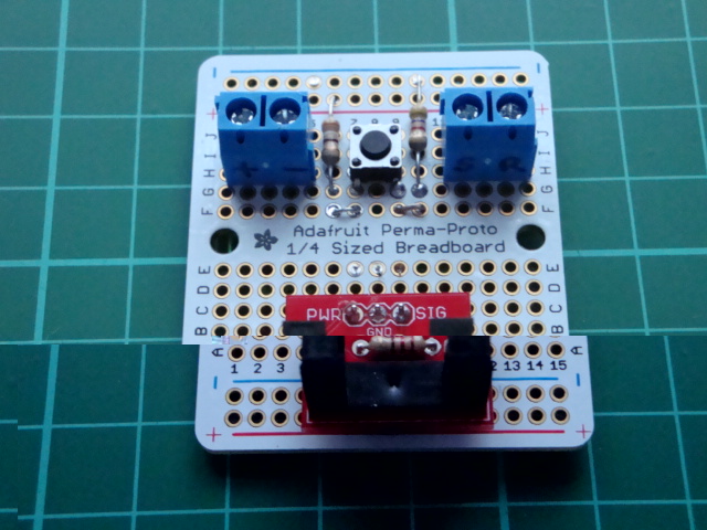

The sensor is a Sharp GP1A57HRJ00F Photo interrupter
Gap = 10mm
It is mounted on a Sparkfun PPBOB-09322 Break-Out Board
This has a 220-ohm resistor and the 3 connections on a small PCB
This assembly was mounted on a small Protoboard along with a reset switch
(This is configured in the same way as the switches on the EB007 switch board)
The sensor and BOB were obtained from Proto PIC in the UK
Program :
The program used here is a simple test routine to verify the hardware
The sensor is connected to ADC0.
With no objects between the Tx & Rx the output is high, when something passes through the gap the output goes lows.
This is read and the count value incremented by 1.
I have used an integer variable for Count, as it may well need to go passed 255

Operation :
By moving an object though the gate, the count will be seen to increase.
The speed of the objects through the gate and the delay statement may need adjustment to suit a specific application.
It will not detect transparent items.
The direction of travel through the gate does not have any effect on the reading (i.e. in from the top or the bottom)

Sensor - Close Up
Sensor - Close Up
Sensor 2.JPG (133.84 KiB) Viewed 2866 times
Test System
Test System
System 1.JPG (135.03 KiB) Viewed 2866 times
