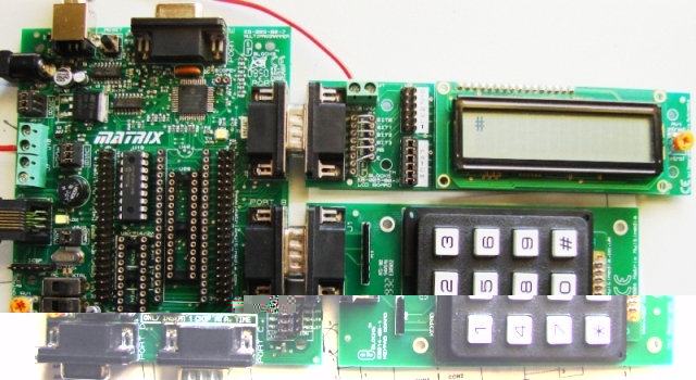

E-blocks that used are:
A) EB014 Matrix Keypad
B) EB-005 LCD board as terminal
C) EB-006 Programming board.

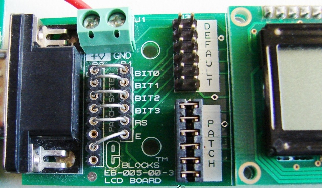

The microcontroller used is an 18 pin P16F819 (you can change it with any equivalent micro, e.g. 16F88) that includes INTOSC module so there is no need for external XTAL or Oscillator. The EB014 Keypad is connected at Port B and the EB005 LCD display is connected at Port A. Some modifications are needed on the LCD board because its ENABLE input is by default connected at Port R"X".5, while in all 18 pin micros the RA.5 is the MCLR input and can’t be used as output.
So, to connect the ENABLE pin to e.g. Port RA.6 of micro firstly we have to remove the sextuple jumper from the "DEFAULT" to the "PATCH" DIL header. Then we can use 6 spare leads from used parts as jumpers to bridge the SIL sockets P1 - P2. In this way the 7th pin of P2, that is numbered "6" and is assigned to Port RA.6, can be connected to "E" pin of P1 that is assigned to the ENABLE input of LCD. See please in the picture.
The program code has obtained through a straightforward application of Flow Code icons. The 4 ROWS are connected to Ports RB.4 – RB.7 which are modified as Inputs and their IOC (or Port) interrupt is enabled. These four Ports are connected to 0V Rail thru four 100KΩ resistors and so are in LOW state. The 3 Columns are connected to Ports RB.0 - RB.1 -RB.2 and are modified as outputs. When a button on keypad is pressed applies a 5V signal on the corresponding ROW which in sequence changes state and causes an Interrupt On Change. This IOC interrupt weak up the micro and calls the macro “SCAN_KEY”.
When the keypad is inactive, the program runs continuously inside the MAIN Loop where the SLEEP command is executed.
Suppose that the button “5” is pressed. Then the IOC interrupt that occurs steers the program flow into “SCAN_SWITCH” macro and the Columns are set one by one in HI state starting from the RB.0. Accordingly the ROWS are detected thru the “switch ROW” icons if their state has changed from LOW to HIGH. In this instance, when the Column RB.1 is set to "1" the ROW RB.5 is also set to "1" because the circuit between them is closed thru the button "5". The HI state of ROW RB.5 is detected from the corresponding "switch ROW" icon and the program flow is turned into its branch “0x20”. Then the number “5” is printed on LCD thru the Component Macro “LCD Display – Print String “5”.
And so on.
In the end of macro "SCAN_SWITCH" all Columns are SET again in HIGH state.
