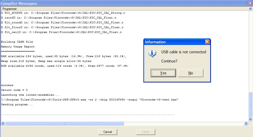

I'm trying to program a PIC16F690 and get the message box that says "USB Cable no Connected. Do you want to Continue". Ultimately, it compiles but doesn't program the device.
I have the Programmer options set to...Location = C:\Program Files\Flowcode\V5\Tools\PICkit2\pk2cmd.exe and the Parameters as -BC:\Program Files\Flowcode\V5\Tools\PICkit2\ -PPIC%p -F%f.hex -M -A5 -R
PicKit2 firmware is V2.32
The PicKit2 works perfectly with Flowcode V4 Pro and the PicKit2 GUI but Flowcode V5 won't see it. Help!
I'm considering upgrading to V5 but I need to resolve this first.
Thanks!
Rich

Thanks...maybe the compiler messages below will help. It appears to want to launch the PPPv3 tool rather than the PicKit2. Also, tried a PicKit3 and it does the same thing.
File name: C:\Documents and Settings\c13393\My Documents\Flowcode\Book\flowcode-v5-test.c
Title:
Description:
Generated by: Flowcode v5.1.0.0
Date: Monday, June 25, 2012 10:29:30
Licence: Free version
***FREE/DEMO VERSION***
NOT FOR COMMERCIAL USE
http://www.matrixmultimedia.com
Compilation is up-to-date
Linking is up-to-date
C:\Program Files\Flowcode\v5\Tools\PPP\PPPv3.exe -cs 2 -chip PIC16F690 -nogui "flowcode-v5-test.hex"
Sending program...
...................................................................................................Return code = 1
Flowcode was unable to transfer the flowchart to the microcontroller. Check the programmer options and physical connections.
FINISHED

hmmm....don't know why the settings changed. They were as you suggested yesterday and this morning. I was moving some things around trying to get it to work so I may have pasted those in there accidentally. At any rate, changed them back and still doesn't work. Sorry for the confusion.
Compiler message list.....
Building CASM file
Memory Usage Report
RAM available:256 bytes, used:38 bytes (14.9%), free:218 bytes (85.1%),
Heap size:218 bytes, Heap max single alloc:94 bytes
ROM available:4096 words, used:119 words (3.0%), free:3977 words (97.0%)
success
Return code = 0
Sending program...
.................................................................................................................................................................................................Return code = 1
FINISHED
Building CASM file
Memory Usage Report
success
Return code = 0
Sending program...
FINISHED

You seem to have the PPP settings where your linker settings should be.
Sending program...
This is not correct and will not work.
I recommend you use the restore defaults option in the compiler options to restore all the correct settings.
Then in the programmer tab of the compiler options change the top two text fields to the following.
Leave the bottom two fields as is to allow you to reconfigure the device configuration using PPP.
Sending program...
Re: PicKit2 = USB Cable not Connected error
Excellent! I think I know what happened to me. I didn't realize that when you select Default while in the Compiler tab, it defaults ALL the tabs and removed the PICKit2 command line path. Also, looks like I prefer to have a -T at the end of the parameters so that it's not held in reset after programming.
Thanks!
Any chance of an answer to above please? Way it’s looking at the moment I am going to have to swap my brand new laptop with my wife’s or I won’t be able to programme PICs.
Is this a similar problem to the Windows 7 one described here http://www.matrixmultimedia.com/mmforum ... f=2&t=8097
i.e. the USB drivers for the PICKIt are not installed? I can’t remember what happened when I first plugged the PICKIT in and whether it self installed any drivers. I did not point it to any special ones. Where do I look to find what it installed? Would using Microchip’s PICKIT installer help?

Unfortunately not the case. I installed the application from your link and it could read from and write to the chip. But no change when trying from Flowcode. Still a code 24 error.Benj wrote:You can download the Microchip stand alone PICKit 2 programmer software from here.
http://ww1.microchip.com/downloads/en/D ... up%20A.zip
If this works then the PK2CMD app used by Flowcode should also work.
At least I now have one method to write to the chip but not the best.
My laptop says it has a 64 bit OS but only under the hardware section, it does not say if it is Windows7 Premium 64bit under the software section.
Could the 64 bit be a problem because your readme file Readme For PK2CMD says “PICkit 2 Command Line Interface (PK2CMD) is a 32-bit command-line interface to the PICkit 2 device programmer” and says "64-bit Vista is not supported at this time” but does not mention Windows 7. As this file and PK2DeviceFile.dat are dated 2009 I suspect they are not fully compatible with Windows 7. Is there an update?
The equivalent readme file for PK3CMD is also 2009 but mentions nothing about versions of Windows. Judging from http://www.microchip.com/forums/tm.aspx ... e=1#605695 it is a USB3.0 compatibility problem and I can't find evidence that Microchip has solved it. But this may be irrelevant to the PICKit 2 problem seeing as that one does work via the PICKit 2 programmer software.
