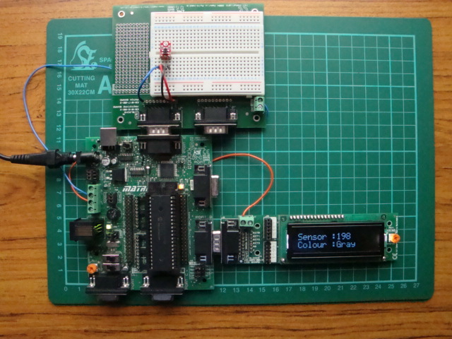

A recent purchase is the Pololu QTR-1A reflectance sensor. This is already mounted on a BOB so it simplifies the way it can be used.
The package contains a small pcb (8mm x 13mm) with the sensor itself, 3x smd components.
Also included is a 3pin SIL header which has to be soldered to the sensor board to allow the signals to be connected.
(It can also be bought as a strip of 8 sensors, which can be broken down to a strips of 6 sensors and 2 sensors respectively.
The data sheet can be downloaded from here
http://www.pololu.com/docs/pdf/0J13/QTR ... n_note.pdf
Reading L-R with the connections at the top
1 = Gnd
2 = 5V
3 = Signal Out.
Signal out is connected to ADC5 on the PIC
The device can be used to sense the difference between a white and a black surface held close to the sensor.
White Surface:
This has a strong reflectance. The output will tend towards 0V
Or 0 if reading as byte or integer
Black Surface:
This has a weak reflectance. The output will tend towards 5V
Or 255 / 1023 if reading as byte or integer.
Equipment:
EB006 Programmer with 16F877A
Port E = EB017 Patch Board
Port B = EB005 LCD Display
Jumper wires to suite patch board
Software:
This simple program is just to show the operation of the device.
It would be very easy to use this as the basis of a white line follower.
The difference between the two levels is very large so would be easy to detect.
I simply setup the LCD as normal.
Then the program drops into an endless loop.
Read the ADC input on ADC5
If less than or equal to a certain value , then colour = White
If greater than or equal to a certain value then colour = Black
If between these values then colour = Gray.
I did wonder if it would give different values for different colours and thus be used as a colour detector, however this does not seem to be the case with this sensor.
But, the device works exactly as it says in the data sheet and gives a strong indication with black or white.
(17.43 KiB) Downloaded 1810 times
