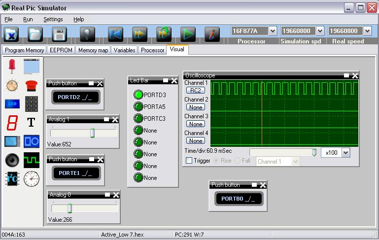

I forget to tell that I have tested the attached program in Real PIC simulator and it works excellent..So it will work in hardware..
Here is the attached pic..
- 877a.JPG (75.86 KiB) Viewed 15073 times

I am sorry to say active_low6 works but not active_low7 although it sure looks right.Enamul wrote:Hi,
I forget to tell that I have tested the attached program in Real PIC simulator and it works excellent..So it will work in hardware..![]()
active_low7 controls led and relay from station 2 but no response from PWM or station 1 controls

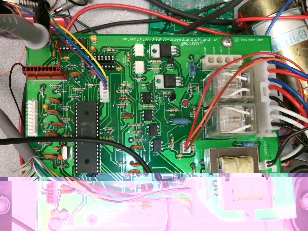

I tried it from both station 1 and station 2 when running from station2 I measured variable voltage on pin 3 an2 but no out put on pin 17 ccp1, also tried to compile for pic16f887 with the same result. is there something I could send that would be helpful compiler messages? maybe because I am using demo version? just ordered professional version from http://microcontrollershop.com/product_ ... ts_id=4137 which for 310.00 usd they are throwing in a programmer board.
- compiler message active_low 7.txt
- (6.72 KiB) Downloaded 321 times
- (253.24 KiB) Downloaded 2343 times

READING ANO GIVES DATA FROM AN1 What the heck?
Using AN0 to set variable speed1 is not working correctly keeps getting value from AN1.
Unless I don't understand ADC(0) should be AN0 correct? and ADC(1) should be AN1 I put a breakpoint just before read ADC(0) please tell me what I am doing wrong.
Checked connections on both knobs (analog inputs) Simulates the same way that it runs.

Re: Active low switch and storing a high bit variable
Have you tried the hex I have posted last time..it doesn't have adc...there might be an issue in adc..as I have swapped those in my program.
I have removed the adc in last one..now I have added it in right station..so it should work..Can you please let me know is that works or not?
YES THAT WORKS the station 2 runs with speed2 set at 200 but station 1 doesn't move with speed value set to 60Enamul wrote:Have you tried the hex I have posted last time..it doesn't have adc...there might be an issue in adc..as I have swapped those in my program.
I have just tested the program in hardware. The program works absolutely fine..So in your case it seems any hardware issue..
THE hex file didn't work for me but I compiled to chip with the fcf and it worked,both stations and pwm varied the speed. just found 1 output 0>C3 which I changed to 1>C3 and then main relay workedEnamul wrote:Hi,
Glad to know that it worked. I was wondering about the performance of Real PIC Simulator bcz not a single time it produces wrong result..I am using 30 days evaluation version and now thinking to buy one. It's handy in answering problem in forum.
By the way which programmer you are using? I guess you didn't get the Multiprogrammer board of MM. Hex should be fine..I have tested both in hardware.
