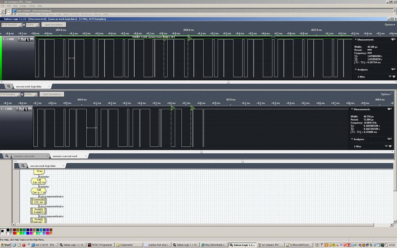

There is the scanbus picture for logic analyzer, upper is fc4 8 bit, which works ok, lower is fc5 for 16 bit, not working...
Both captures start at the same point, end of the searchrom command.
If you look between markers 1 and 2, there is some diffrence, but the transmission shoud be same, because it seems to be familycode section (16 at ds1820).
(235.02 KiB) Downloaded 2791 times
Notice that the scale is not exactly same...

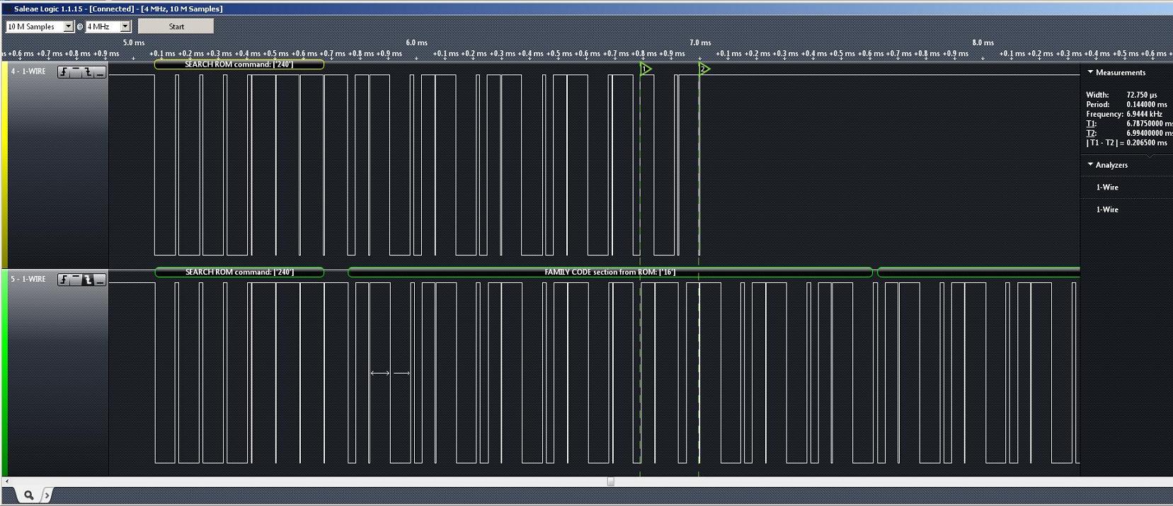

There is better capture for logic analyzer, the scale is same, and the timing are almos equal.
I tweaked the timings at the FC5 16bit as close the FC4 8 bit as the delays allow, so the problem is not the timings...
The working FC4 8 bit is the lower capture.. I swithc the sensord, to confirm that the problem isn't the sensor and let you know then..
At that capture, should be quite easy compare the code where thing goes wrong (between the t1 and t2 timing markers)...
Yep, can confirm that the problem ain't the sensor...
T:Mika

Now I think that I understand the "init" protocol of onewire, but the Dallas document was quite confusing..
So the slave device sends first the bit,then same bit inverted, and then master responds at the bit which was first send (not inverted), but if the bus has devices which sends 01 and 10 the bits are 00 (bus is 0 dominant), and then master chooses the device which will continue, and sends a correct bit..
If you look at the logic data above you see that the slave send bit starts at the +0.7ms, and the slave sends 10, the inverted byte (0) is just before timing marker 1, BUT then, the master should send 1, and it sends it at the lower capture, just at the point where is the [16], but the upper capture (which is at FC5), the master send 0!! So there is the error, now when the master responce don't match the slave bit, the slave goes at the "sleep" mode, and don't respond anythin else than busreset, so thats why the code gives error 2, the bus is high all the read time...
But I don't know why that responce is wrong, continue investigatin (it would be nice to see if the 8bit version gives same error at the same point, can anybody scan it with logic analyzer?)...
