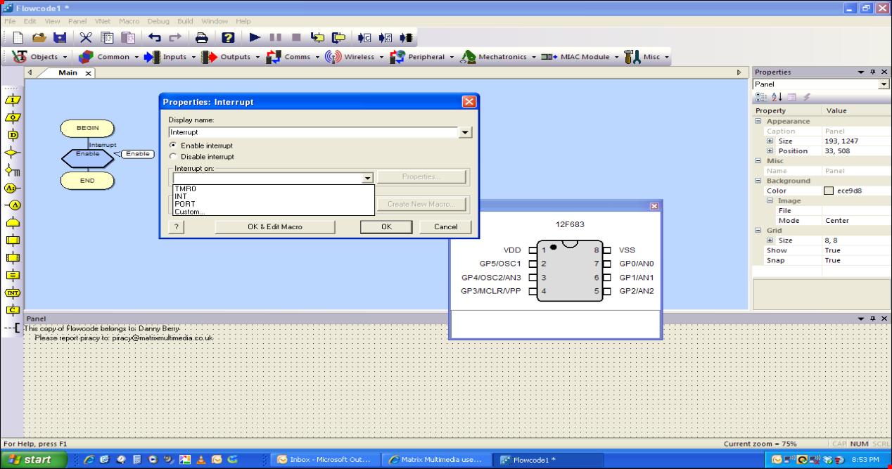

I posted a question about this in the minor fixes and was ask to move to here in a seperate thread. Can ayone tell me why I can't see all of the timers when I tried to use this pic in flowcode 5.4. It should have (timer0,1,2) however I only see timer0. My question is simply is there an updated FCD file and is that the reason I can't see the other timers in flowcode?

Apparently I had a corrupted or outdated version. If there are others that have the same problem. Here is the fix. :D
I haven't done anything to the FCD still I can see three timers in Flowcode.
