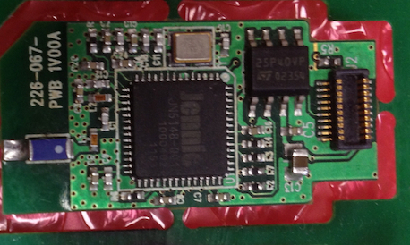

Re: Advice Sought: Flowcode V5 with ICD3 ?
This is the type of hand assembly and prototype work we do at prices you really wouldn't believe. This board is 0402.
In fact if anyone from the Matrix Multimedia team is reading this they should be getting quotes from us for their work. Our customers include EADS, Cooper Controls, Vishey, LG etc....
