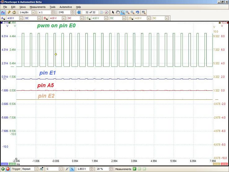

if i enable pwm 2 on E0 i get with a 10k pulldown 100mv of pwm signal on E1 and A5

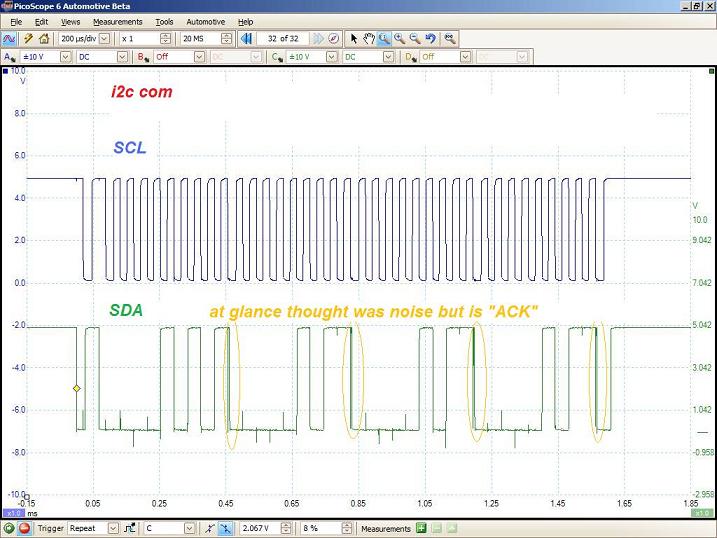

when using i2c with 1k pullups and 10k pulldowns the clock cuts into the sda line at certain periods

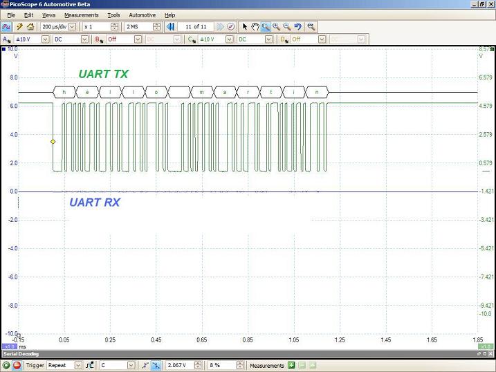

alright, got my pico and did some testing.... this looks alot different when using the pico with a different power supply on the board! looks to be ok, there is a slight amount of noise from chip pins that are close to each at the chip, t his is still there even if the traces are ran in complete different directions... the i2c problem is no problem at all (my bad), i tested on the 40 pin dip version of the 1939 and i have the same consistant pulse, it hit me this is believed to the ACK responce :lol:
here are the waveforms during test, im running 20Mhz sample rate but using software lowpass filter set to 1Mhz so the waves appear to be cleaner than what they actually are

on the i2c waveform im not sure what the spikes are, are they ack? i can download that program to various chips/packages and i get that so it appears normal, just doesnt make any sense as it gets read in the middle so it wouldnt effect the read
