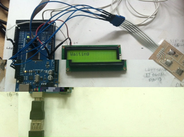

I have attempted to code a program that recognizes a push-button push and displays some text as a result. It is attached. I am using PortB Change.
The program 1.)Calls Init (Sets LCD Contrast and Outputs 1 to switches).
2.)Then a macro, that senses the switch positions and assigns their input state to a bool variable.
3.)Then an ISR to print "Got It", if a PB is pushed.
The while(1) loop prints "waiting", and cycles forever, waiting for the ISR, in which "Got It" would be displayed in the LCD.
Working with interrupts.

- Picture if the setup.
- BreadBoard Setup (2).JPG (108.14 KiB) Viewed 4468 times

- I can not get it to simulate or work on an Arduino MEGA, with Pushbuttons and an LCD. The LCD display's "waiting", and would display "Got it" if it worked.
- (19.23 KiB) Downloaded 257 times

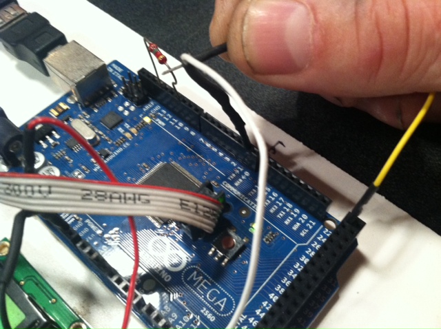

There must be a mapping problem. Of the 2 FC programs attached, the only difference is that the interrupt is either a PortB change (No work) or a PortE/J change (Works).
In both cases, I look at pin B5 to invoke the interrupt. I might add that the interrupt works if the input is on B0 to B6.
- Photo showing triggering the interrupt and LED.
- Resistor_ Gnd to B5.JPG (138.18 KiB) Viewed 4414 times
