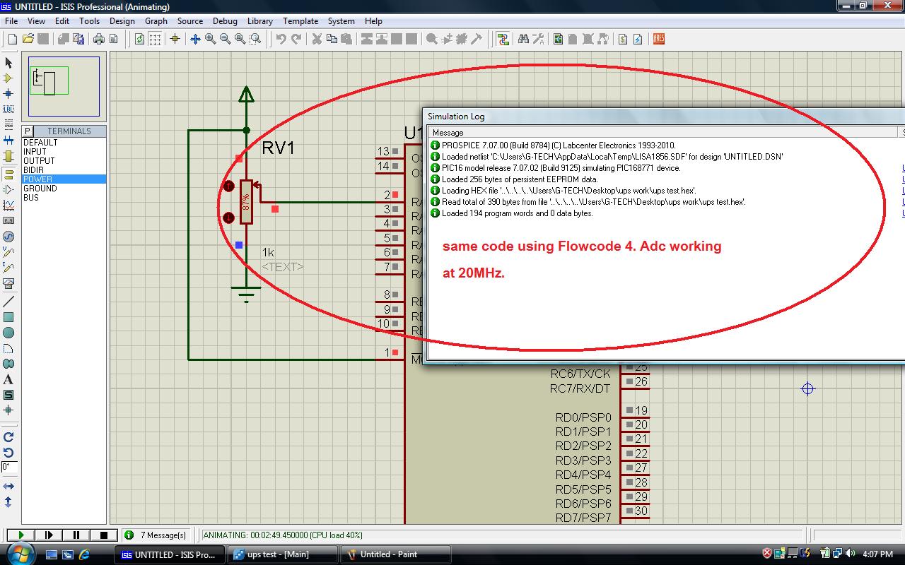

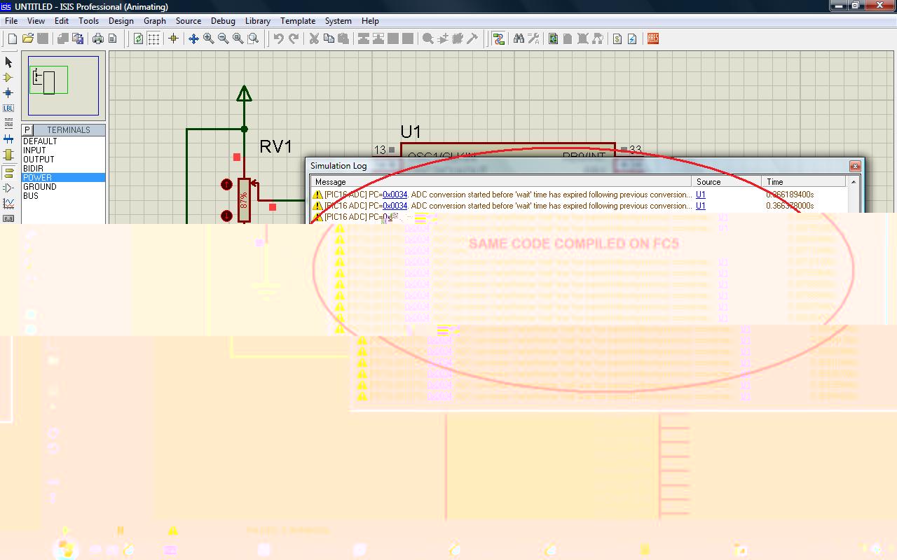

martin can u suggest me a chip having equal as much IO's as 16f877a have?
another problem in Flowcode 5 ADC Conversion i am posting sc's for details.
(180.69 KiB) Downloaded 3707 times
greentech
Flowcode V4 User
Posts: 158
Joined: Mon Jan 31, 2011 2:11 pm
Has thanked: 10 times
Been thanked: 2 times
Re: inverted pwm
Post by greentech »
program compiled with fc4 runs ok but adc prog compiled by fc5 gives this error
{"ADC Conversion started before wait time has expired following previous conersion or channel change"} i dont know why?
program speed set on both fcv4 & 5= 20MHZ
(242.32 KiB) Downloaded 3705 times
