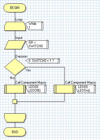

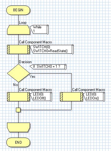

Below the little program working and the one not working at all.
Thanks for looking into this!
Ronald
Not Working Code
Not Working Code
Working Code

This is an issue for all processors with 16 bit ports. The switch component tries to read a 16 bit value into an 8 bit variable. Drop the attached file in the components directory to solve the issue.
FC5_PIC16BIT_SWITCH.c
(7.53 KiB) Downloaded 240 times
