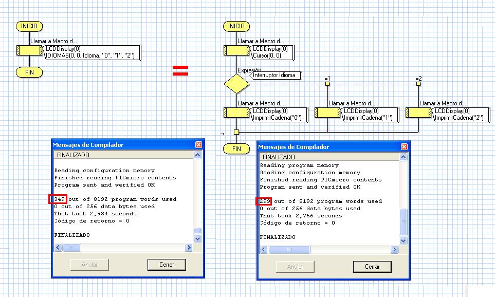

I have a question, my intention to make the macro was to save program memory, but the result is greater with the macro setting separate blocks, why?? I do not understand.
Someone can explain??
Thank you very much again
Prueba_codigo_display.fcf
(14.53 KiB) Downloaded 330 times
LeighM
Posts: 2178
Has thanked: 481 times
Been thanked: 699 times
Re: Printing to LCD in 4 languages ​​in C
Post by LeighM »
Compare the two generated .casm files. These will show you which macros are being used and how much assembler code and hence memory space they require.
Leigh
tello
Posts: 94
Joined: Wed Jan 16, 2013 11:37 am
Has thanked: 56 times
Been thanked: 16 times
Post by tello »
Thanks, I looked CASM file but do not understand much of anything.
