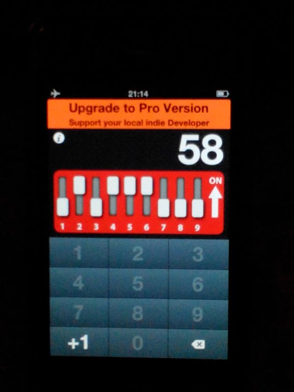

As for smart calculators... for my work to explain in a simple way BCD switches and their codes to installers for 'on the road' i have found a very simple and usefull App for the Iphone. there are more but the most elegant one is 'DMXdip'. It shows a 9Bit dipswitch and a numberpad. It converts direct any dipswitch setting to decimal and vice versa. Yeah, because it's free it has a NAG function build in but hé
