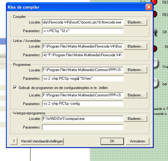

Jan van de Vooren
- Posts: 7
- Joined: Fri Feb 15, 2013 9:21 pm
- Has thanked: 2 times
Re: Problems with PPP V3
Hi Medelec 35,
Many thanks for your quick reply,
I tried what you mentioned, it was not the firewall (it works for 5 years already in the same way).
I What i did is, install the new PPP from the Zip file you send me. And change the direction from COMMON to TOOLS directory.
Than i tried and found out that I have the same problem, but i see just on the right side of my screen that the window is out of sight for me.
I just can take the left line and pull it to the left. Than everything is ok.
But i have the same problem when I push the Option button on the screen.
And that is the same problem, it is out of sight for me.
I change the resolution for a while so i can get it. But the question is now.
How can I change the "start"position from those windows on the screen when I open the configuration screen?
But beside this issue, it seems there is still something wrong with writing the HEX file to the processor (16F88)
Before the problems started, the program worked fine also in the simulation, but now not on the board anymore.
I hope You can help me with this.

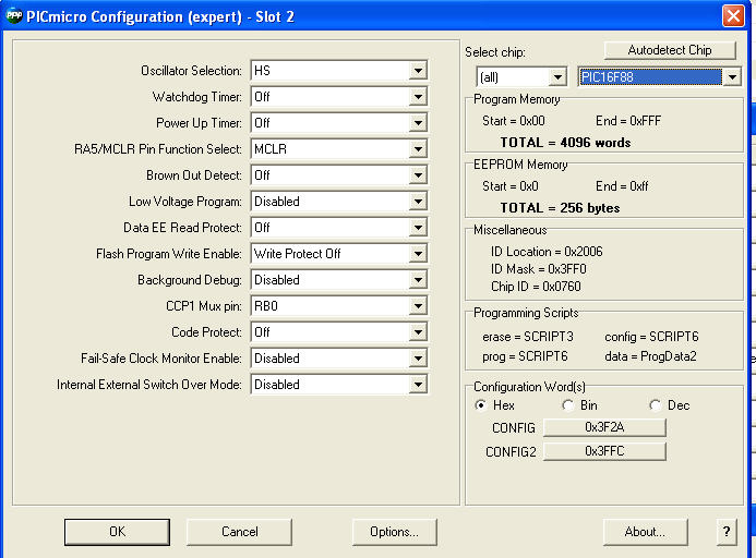

Hi Medelec,
I found out that the configuration settings for the 16F88 config 1 and config 2 is different in your new PPPv3.
Now I know that the old PPP worked but was out of screen (happens when you use 2 monitors).
So I changed to thw old one again and checked the difference between them. Config 1 Has to Be 0x3F2A and config 2 Has to Be = 0x3FFC !
Than everything works fine again.
So the only thing is now how to get the screens on the place where I want when I start the config screen.
If You know a solution, please let me know.
Thanks a lot for now,
Regards Jan.
Regards Jan.
Hi Martin,
I try to reproduce but i can't. I think config 2 was 0x3FFF in stead of 0x3FFC.
further see img.
I also saw that the ID Location in some settings (not yours) was 0x2008 and than 0x2007 and in this setting is now 0x2006.
But now it is working.
Thanks for your help Martin,
Greetings Jan
further see img.
Greetings Jan
- config (I have now).jpg (76.95 KiB) Viewed 7331 times
- Here are the parameters from my version
- instelling PPP.jpg (77.66 KiB) Viewed 7331 times
ok no worries.
If config 1 was 0x3FFF, then hardware will defiantly not work at all.
With config2 set at 0x3FFF hardware should work just fine since 0x3FFC should only change Fail safe monitor & internal switch over modes.
Still as long as your hardware is working, that's the important thing,
That is when configuration settings have not been altered and left as manufacture default settings.Jan van de Vooren wrote:config 2 was 0x3FFF
