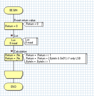

I have to read the bits of a byte in the following order: MSB..LSB. The best option for me is to read the staus of the C-register after roll left (Byte<<1).
I have 2 questions:
1) How can I get the status of C into a Flowcode vaiable (boolean of byte)?
2) or is there an other, easier way to change the bit oder in opposite direction?
Kind regards
Jan Lichtenbelt

Hi Jan,
Yep that looks good. I was going to suggest a way of doing it but your way is more efficient so I would use the method your currently using.
My method was going to look like this.
Return = 0
Index = 0
While Index < 8
Bit = (ByteIn & (1 << Index)) >> Index
Return = Return | (Bit << (7 - Index))
Index = Index + 1
Return = 0
Index = 0
While Index < 8
Index = Index + 1

Re: Status C into Flowcode variable
Return = 0
for (idx = 0; idx < 8; idx++)
Bit = !!(ByteIn & (1 << idx));
Return |= (Bit << (7 - idx));
