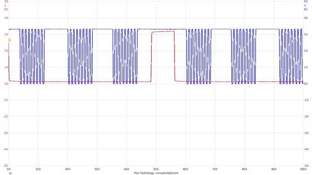

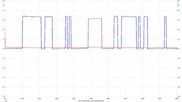

I have attached a short Flowcode 6 file for accepting signals from the EB085 by the dsPIC33FJ128GP802, obviously based closely on MM's F5/6 example (I don't have a PIC licence for F6). I hope it helps others confused by the plethora of options! The program delivers a 16 bit word "signal" at a 20 kHz sample rate. This could be increased by going for The AD7680's 20 bit output option but it's plenty for my job!

The pictures show the lovely clean CS and SCK signals and an example of the 16bit output (a 2Vpp signal at 8KHz)
EB085_SS_ and_SCK waveforms.jpg (17.67 KiB) Viewed 4359 times
