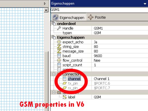

I've made two flowcharts (in V5.5.. and V6.04) which do nothing more than start a LCD and initialise the GSM module.
If I look at the response from the initialise command, most of the time it returns 254 (in V5) and sometimes 43 (in V6).

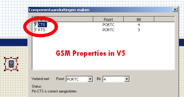

Strange thing between the component in V5 and 6 is that in V5 I need to specify the connections for CTS and RTC (C4 and C3)
In V6 I need to specify the connections for TX and RX. (C6 and C7).
Strange because I would think that Flowcode would know the standard UART pins on the controller and use these.
First question: why the difference between V5 and V6 in connections? (should RX and TX in V6 not ben CTS and RTC)?
I've tried to change the setting for the channel in V6 from "channel 1" to "software", but this doesn't work.
The drop down box changes back to "channel 1". (please get us back to the pop-up screens from V5 :? )
Question 2: is there a reason why I can't change the channel to "software"?

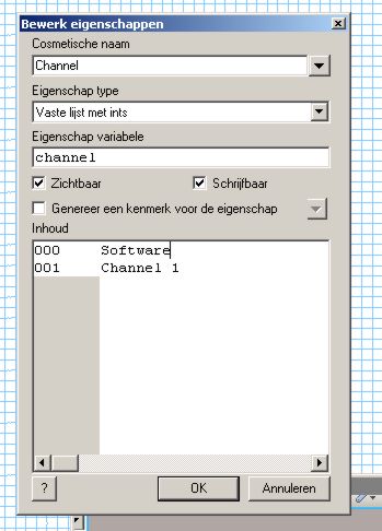

BTW: while trying to change the channel into "software" it seems I erased the "software" option in the settings.
Is the setting for software "000" in the channel the right one?

Re: GSM module EB066: initialise problem
Set the Flowcontrol property to Yes and the Flow control I/O pins will appear allowing you to configure them.
The GSM component uses an interrupt method for receiving to try and make it very reliable. This interrupt is not available in software mode and so software mode is not available for this component.

I checked the "flowcontrol" to Yes and I found that the CTS/RTS pins were dedicated to the B-port (instead of like the TX-RX on the C port).
Maybe this could be something to change in next updates? If the RX-TX pins are on a a certain port, the (hidden CTS/RTS) would change to the same port?
