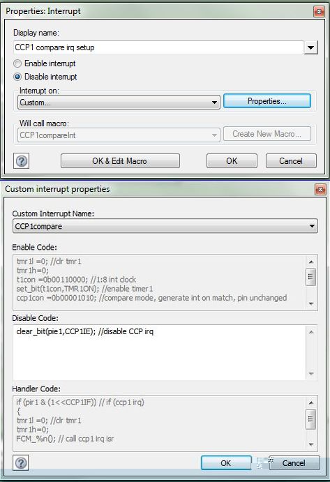

That worked thanks... I actually found that you do not need to add another interrupt but instead from the Properties:Interrupt window just select the Disable interrupt radio button instead of the Enable interrupt, then pressing the Properties button opens the Custom interrupt properties with the Disable code part available for editing.
This worked for me although on one occasion the Enable code and the Handler code did not show (grayed out and blank) and after editing the Disable code and attempting to OK, it gave an error asking for all parts to be filled in. I tried to re-create this but could not.
I understand that this allows one to enable (by adding the custom interrupt with the Enable interrupt radio button selected) or disable the interrupt (by adding the custom interrupt with the Disable interrupt radio button selected) at will anywhere desired.
I am attaching a JPG just to show how to access the Disable code part... was right there under my eyes.
I'll check the example shortly, tks
