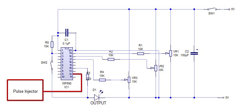

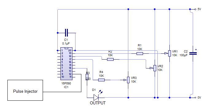

Could somebody take a look at my flowchart and tell me how I can improve the trigger reaction time please.
I used a scope to measure from the rising edge of the signal in to the rising edge of the trigger signal out. I took about 10 measurements and then got an avarage delay time 860ms. Can this be improved?
I've also noticed that the signal in has to have a duty of at least 440ms for the trigger signal out reacts. I was hoping for much quicker reaction and detection times but maybe I've done something wrong in my flowchart??
I have attached the flowchart for you guys to check out.
Once again, appreciate your guys time to help me on this............John

When you do some more testing, Can you post results along with volatages on AN0, An1 & An2
Also a circuit diagram showing all the pin connections may help

Hello Martin, here are my test results. I have also included a schematic as to how I wired up my circuit. Maybe something wrong there???
Settings
Set VDD at 4.738
AN0 at 1.88V
AN1 at 2.24V
AN2 at 0.48V
Input pulse at 100ms duty
Results
Trigger ON period 32 seconds
Trigger Inhibit 42 seconds
Must be something I've done with my circuit as the results are wildly different from yours. I used your flowchart to program the chip. Also tried two different chips but same result.
Just so you are aware.......I've removed the GREEN LED from the flowchart as it wasnt really needed.
Thanks again........John

Re: Reaction & Detection Times
Hi John,
Looking at your circuit I can see the issue.
The ADC values are read only when A5 is at 0V since you have a switch on your flowchart.
On your hardware it looks like A5 hard wired to +5V!
Therefore ADC Values are never read, so the varaible will just contain a permanent random number
I did state:
What you can do it pull A5 high with a 10K resistor.Short A5 to 0V, set pots then remove short.
I did state:
i can change the flowchart if you did not want a switch?medelec35 wrote:What I was thinking of is pot readings takes a certain time.
Therefore the pot reading can be done when the switch is in the off position.
Your right again......... The slide switch I had in the flowchart was just to simulate the input signal.
I'll redraw the schematic and repost tomorrow. Are you saying we should get rid of the slide switch? If yes then how will we simulate a trigger signal??
Anyway, thanks again, will post schematic tomorrow. I meant to also tell you that the reaction times I got were just about bang on to what you got. Really pleased with that outcome.
Take care......John
Take care......John
Hi John,
With This Flowchart you just require a Switch in series with batteries and PCB.
No connections to A5 are necessary.
When you apply power to PCB then the pots are read.
They are constantly read until trigger is detected.
To help reduce reaction time I have use an interrupt on change.
Whilst in triggered state, pots are no longer read until triggered state has ended.
During compiling you will get this message:
That is not an issue at all.
Circuit will not be affected in any way and message can be ignored.
In light of this, I have changed your flowchart.JDR04 wrote:If possible, I'd prefer not to do that as it seems a bit clumsy having to fiddle with a switch each time I need to change the pot settings. The only reason I have the switch is to prevent me having to keep removing the batteries. So, in summary, can we avoid having to use a switch each time I need to change a pot setting?
IRTRIGGER 1.2.c(966): WARNING: This interrupt has previously been enabled, so the macro <IOCDetected> may never get called.
- IRTRIGGER 1.2.fcf
- (18.88 KiB) Downloaded 413 times
Hi Martin, I have redrawn the schematic to what I think I understand from your suggestion.
The schematic is attached and would appreciate your comments.
Thanks again....John
- Trigger 2c.jpg (26.42 KiB) Viewed 17531 times
