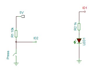

Refer to the circuit diagram for the connections of both circuits, these will be use in subsequent examples as well.
IO1 : This is configured as an output and will be used to turn on a standard Red LED.
The on screen button is configured as toggle, so its touch on touch off.
The output pin is configured as
Idle State = Low
Pulse Duration = 0 (This means stay on. A duration of 1000 would turn on for 1000ms, and then off again.)
IO2: This is configured as an input and will be used to read a standard Push To Make Switch.
Idle State = High
Pulse Duration = 0
The idle state is set to high as the push switch on the development board pulls the pin low to activate it.
These configurations are used in the subsequent examples.
Example 2 :
The 5V supply is connected via a 10K-ohm resistor to the pushbutton and then to the IO2 pin on the display. The other side of the button is connected to ground.
When the button is pressed the IO2 pin is pulled low.
Flowcode reads the status of the IO2 from the display and sets Port B0
(Shown on the LED E-Block)
Button Pressed IO2 = Low Port B0 High – E-Block LED On
Button Released IO2 = High Port B0 Low –E-Block LED Off
Example 3:
Bit A0 on the E-Block Switch Board is read by Flowcode.
The value (0 or 1) is passed to the display and IO1 is set accordingly.
When this goes high, the LED connected to pin IO1 via a 1K-ohn resistor is turned on.
