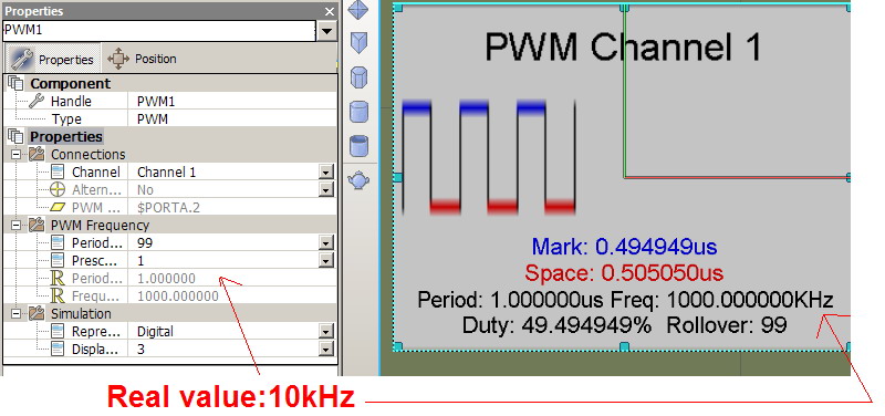

I found a small error in the PWM setting.
Period register is changed, sometimes pointing to the wrong frequency of the panel.
Added to the picture.
