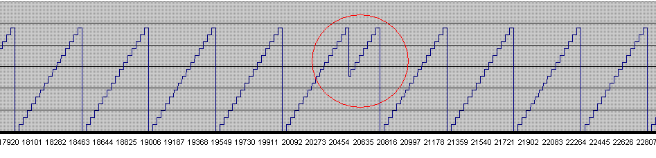

I loaded the data into excel table to see what's wrong and I see that starting from approx. 20.000 sample I have skipped data (I implemented a flag to skip buffer overwrite while FAT is flushing it). After that the buffer pauses each 16380-16390 samples. The problem for me looks like the FAT is writing data slower and slower, but I wonder, why it do this every 4th cycle and not each cycle. The SD card is enough quick to write data much faster than this.
