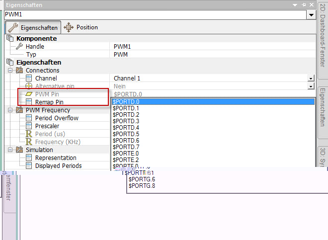

The dsPIC has remap able pins that is the reason that the PWM is not shown tied to a specific pin
Place a PWM component on the Dashboard >> click on it and go to the properties panel
then see PWM >> remap pin select your pin from the popup menu
You will find the where the pins can map to in the datasheet()microchip) under Remap able Pin section
