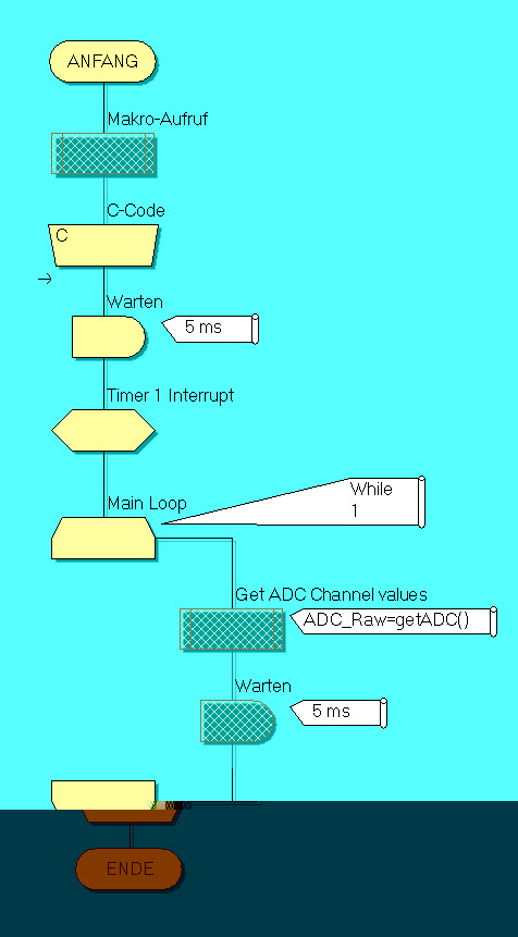

I configure the Clock setting on a dsPIC33EP by including a C file in a macro then call the macro at the beginning of the Code or flow diagram (it is the fisrt function call)
this code get never execute as you will see that my Timing is running 3 time to slow.
I tested this by setting up a T1 interrupt at 100Hz = 10mSec I read in the scope ~28mSec
see screen prints 1&2
The I just deactivate macro and place a C call components with the same code as in the macro then the Timing is 100% (10mSec)correct see screen print 3&4
I did not look into the generated C code to try and see why this is happening .
I guess my question is it not possible to call c code from outside the main Flow diagram ?
Thank you for helping me understand this

C code calls are allowed anywhere. I have used C code in macros without any issues.

Thank you for the reply kersing!kersing wrote:C code calls are allowed anywhere. I have used C code in macros without any issues.
However, having encountered issues with clock settings in the past my best practice is to always do this in a C code icon in the main program to make sure nothing interferes with it.
The macro certainly gets not called correctly or something ,I always get worried when a tool does something that I do not know what it is doing ,
