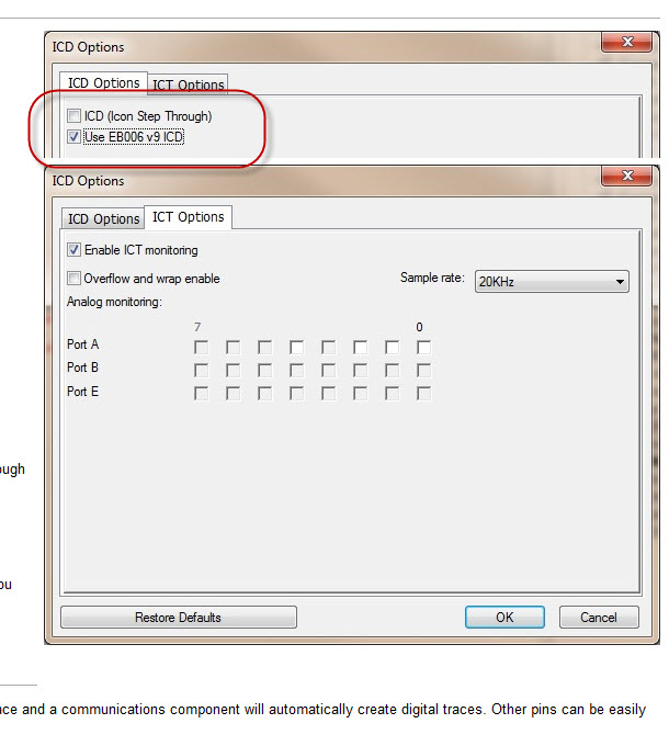

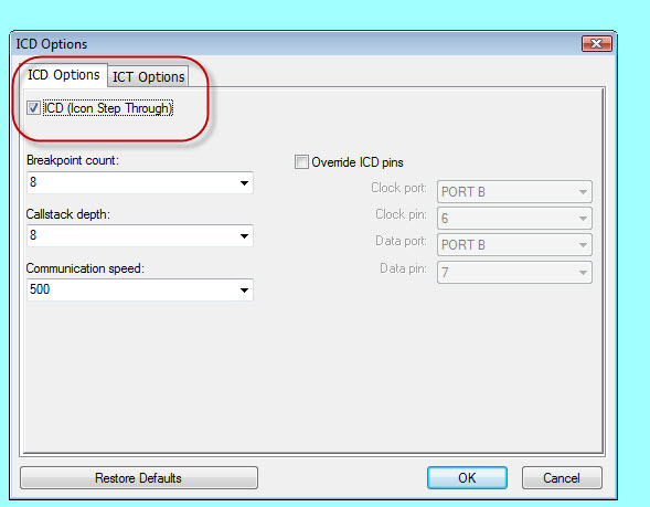

(4) The property page of the Ghost in my FC are different from the help file for Ghost is this correct
first picture = help file second my FC window
EB006V9 ICD

Help file just requires updating as that is what ICD options used to look like before a major update.QMESAR wrote:(4) The property page of the Ghost in my FC are different from the help file for Ghost is this correct
