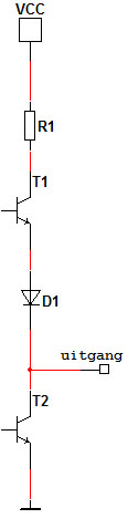

Thanks for your reaction. I do not found in the specifications. But I found it in Wikipedia under TTL.
With 2 outputs, one high and one low, connected external with a 330 Ohm resistance I found R1 to be about 72 Ohm and the voltage Vce over the T1 to be 2V with a current of 12 mA. (PIC16F876A used)
I never realised that ouput high will not be 5V and output low will not be 0V. In the case above they will be respectively 4 and 0.2 Volt.

No you should get pretty much 5V for an output high and 0V for an output low, depending on how much current is being drawn.
This is the circuitry of an I/O pin in the 16F876A.
FETs are used as they don't have the inherent voltage drops that transistors have. Instead they have a resistance but this will be very low, probably only a fraction of an Ohm.
