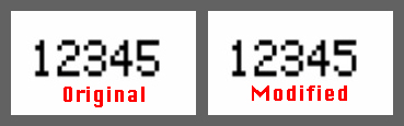

1: The number 5 is ugly. Is it possible to change to a better look type? See picture, some Photoshop work.

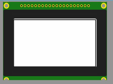

2: In the simulation, not possible to use the first line of the display. The first line never shown.

First please can you make sure you are running the latest version of Flowcode 6.
I have hopefully already fixed the offset bug and in the attached component I have also changed the font for character '5' as requested.
Base_GLCD.fcpx

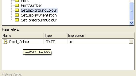

The "SetForegroundColor" and "SetBackgroundColor" commands works. But! In the simulation it has no any effect, in the HW the colors has interchanged.
The Help Tag (and the Flocode online help) tells me 0 means white, 1 means black but in the HW 0 means black, 1 means white. In the HW the foreground and background colors starting interchanged, not as shown in the simulation.

I made some tests, my previous post contains mistakes because the bug a little bit complicated.
The basic problem in the "SetBackgroundColour" and in the "SetForegroundColour". 0 means black, 1 means white. It's working as same as in the simulation and in the HW.
Bigger problem found in the "ClearDisplay" command. In this command, 1 means white in the simulation, in the HW, 1 means black. When you set the BGColour to 0 and clears the display, the simulator turns the display to black, the HW turns it to white.
