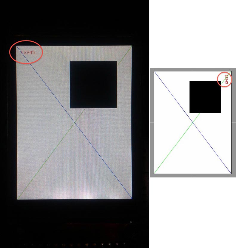

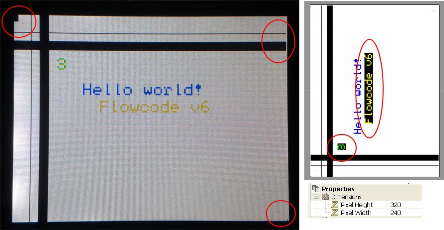

I tested a GLCD and found some bugs. Without any extra setup the results like this:
(55.85 KiB) Downloaded 2447 times
Well, i set the display from 240 x 320 pixels to 320 x 240, and set the display orientation to 1. It's nearly perfect:
(50.99 KiB) Downloaded 2447 times
Both versions uploaded (ILI9341.zip).

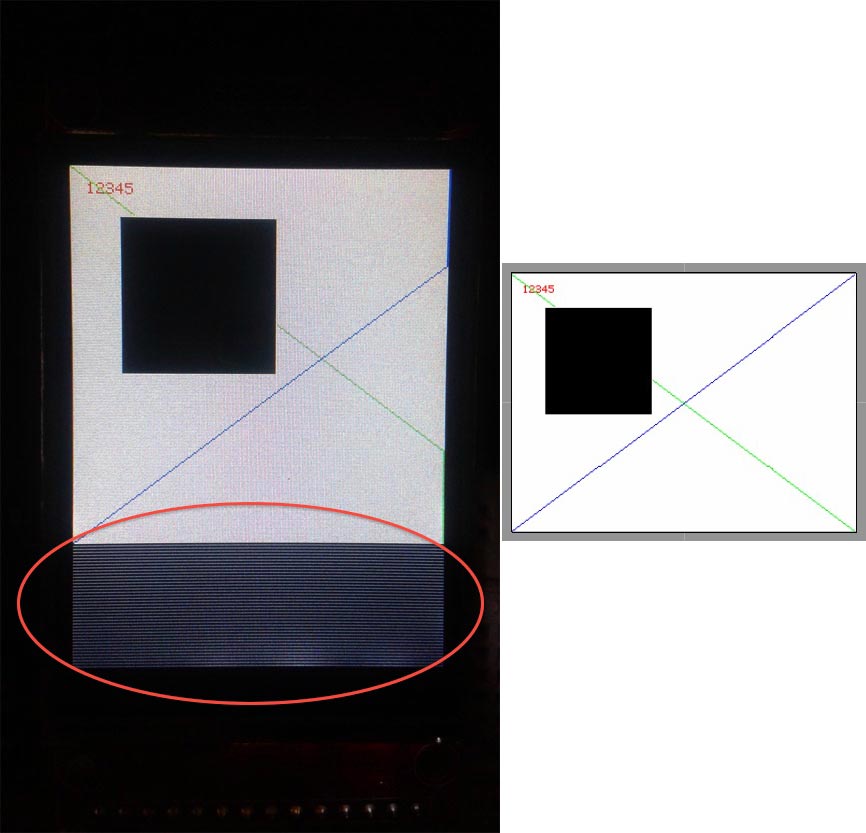

Speed test. The conroller is running at 64 MHz. To fill the display with lines, took ~42 sec without the initialization. Is this normal? Looks slow.
Geometry test. In the "X" coordinatas, the first pixel numbered 1, the last is 320, in the "Y" coordinatas the first pixel numbered 0, the last 239. The "PrintNumber" & the "Print" command always printing the background.

The geometry problem exists (i think) in all gLCDs, if the display orientation is other than 0. Tested with: KS0108, ILI9341, SSD1306 (I2C).

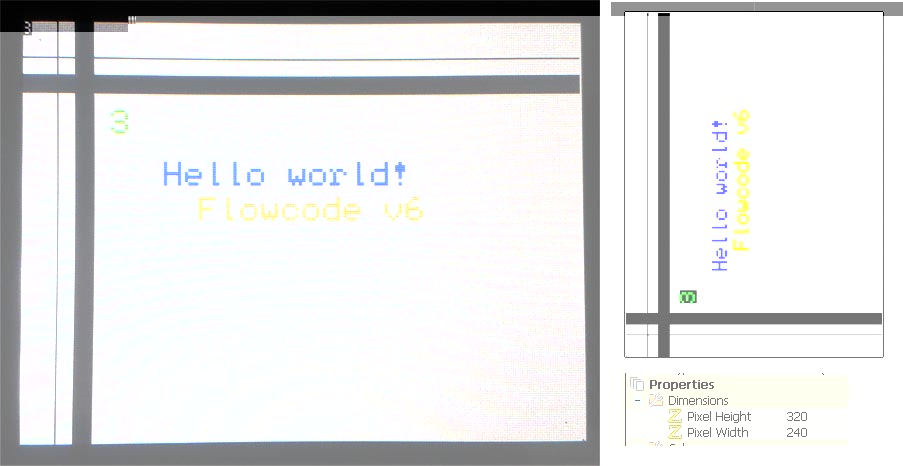

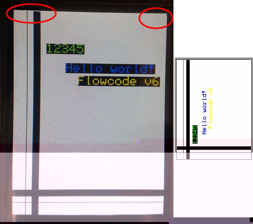

Some results with the new component. The X & Y coordinatas shift still exists. LED connection still exists. When printing number(s) or string with background on, the BG not drawn but in the top left corner the numbers and/or the letters printed with the smallest font size, see pictures.
Re: GLCD (ILI9341) bugs
Ok thanks for letting me know.
I have found the problem with the text background and hopefully this has now been fixed.
This may be down to your specific LCD, the controller chips can be wired to the physical display in numerous ways. I have seen a lot of examples where 0,0 on the controller IC is not 0,0 on the display. I'm not sure what we can do about this. Maybe I could create a couple of offset properties to allow you to specify the offset on a specific display. I will look into this to see how possible it is. What do the offsets seem to be on your display?

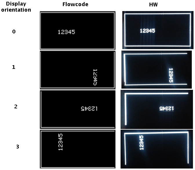

Offset properties is a good idea. But! The offset problem exists only in the HW, when display orientation is not zero. This offset problem is exists in gLCD KS0108 too. To see what is the problem exactly, i'll make some test patterns.
Aha I see, Ok I will investigate this. I'm thinking about another issue on some displays where the pixels are permanently offset. The offset properties won't effect the sim.
If we can narrow down the corruption to one of the draw routines then that might help. If you put delays in between your test pattern then you might be able to see when they are occurring.

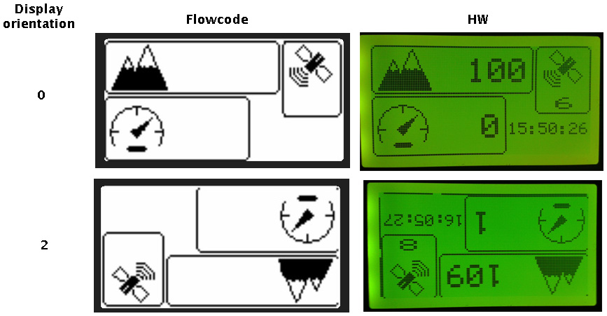

Well, the latest ILI9341 component is working well, except the X and Y coordinatas problem. The basic bug, i think, about the Width and Height of the display. The HW is 320 x 240 pixels, but the initialisation process runs as 240 x 320 pixels. See the first picture in this topic. It is hard to show the XY problem because of the 320 x 240 vs 240 x 320 problem. But, the bug is exists in the SSD1306 & KS0108 components too (and all other gLCDs?). The XY bug is hidden until you using the default orientation. It's not problem because the initialisation process good, you can use all the surface of the display except (?) ILI9341. At this time i've got only this three type of gLCDs, and i can't test others. Well, here is the results about the XY tests in SSD1306 & KS0108.
All the best!
Great that should give me what I need to fix the problems. Your pixel images look really nice on the displays!
