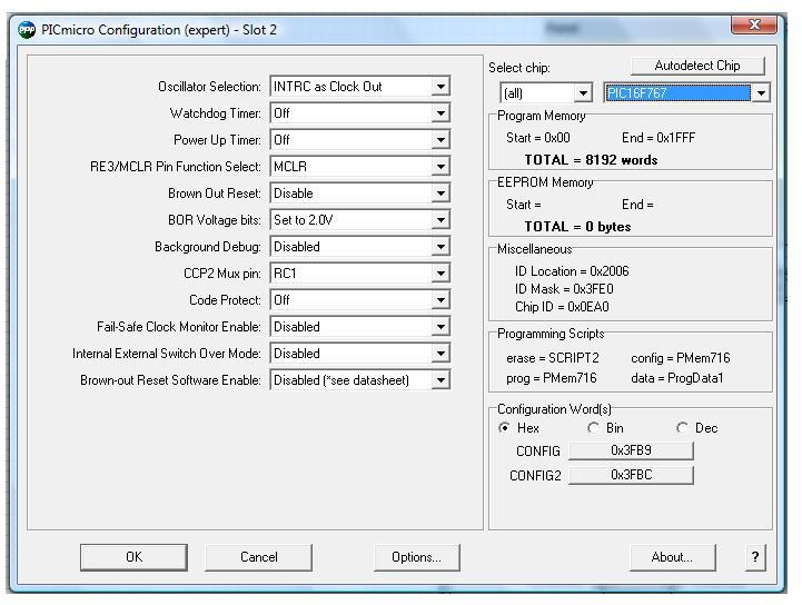

Here are the configuration settings I have done so far.
INTRC CLOCK OUT - To run the chip on its internal RC clock.
MCLR PIN = As a MCLR pin as I do not need it as a digital input at this stage. When inserted into the actual circuit I have tied it to VDD by way of a 10K resistor as per datasheet.
BOR- Set it to 2.0V, safe voltage to run Vdd down to?
PWM 2 - Dont need it set to any PWM channel as the servo signal wire is connected to PIN 2 (RA0/AN0)on the chip. ?????
Any help is appreciated........John

Re: Servo Program Settings
Hi John.
Using INTRC as clock out just means port the clock frequency is present on RA6.
If you wish to use RA6 as I/O pin at some point,then just select INRC as port I/O
I believe the default internal clock frequency is 31.25KHz.
So you will need to add to the very start of main a C code block with
Then should be good to go.
It's always good practice before using any components that is vital on the timing e.g. servo's LCD's timer interrupts etc.
To do a 1 second flash test first.
Can save a load of headaches and time in the long run.
For more advice you can also look here
Looking at your flowchart it looking like you have thought of this but will leave comments in as it may help others.
Also you don't need to keep calling the servo enable.
Since you don't have servo disabled you can place enable after osccon C code block and before start of main.
If you are still stuck then if you post a flowchart, we can look at it for you.

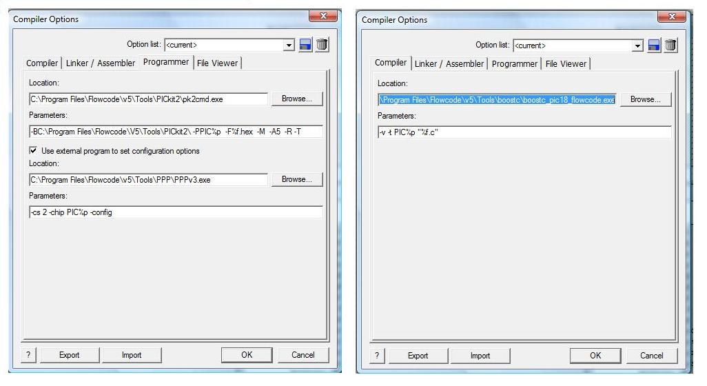

Hi Martin, tried the program but nothing worked. So, I decided to start from the very begining again and simply get the chip to flash a single LED in the hope to see if my programmer is programming OK.
Well that did not work either. I have checked it over but am clearly missing something. Theres also a photograph of how I have connected the PICKIT 2 programmer to my 16F767 chip.
I would appreciate it if you or anybody else would take a look at the atchments and point out where I have gone wrong please.
Thanks for your time .......John

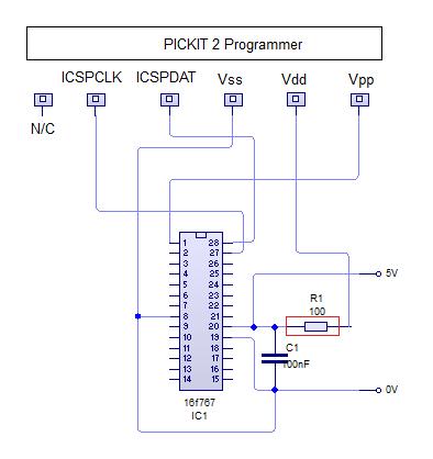

I've attached a schematic as to how I inserted the 100 ohm resistor for you to check I did it correctly.
Thanks again......John
Hi John,
Sounds to me like flowcode is unable to directly communicate with PICkit programmer.
When it does and programs target device you should see:
http://www.flowcode.co.uk/mmforums/viewt ... 22&#p57993
If you go to where you flowchart is stored/compiled and post the file that contains .msg.txt
E.g
Then we may see whats going on?
Its possible that an antivirus or firewall is preventing access?
What antivirus and firewall do you have?
What I do when programming is during compiling lookout for the following symbols to appear(at least forward slashes): Then I know all has gone well!

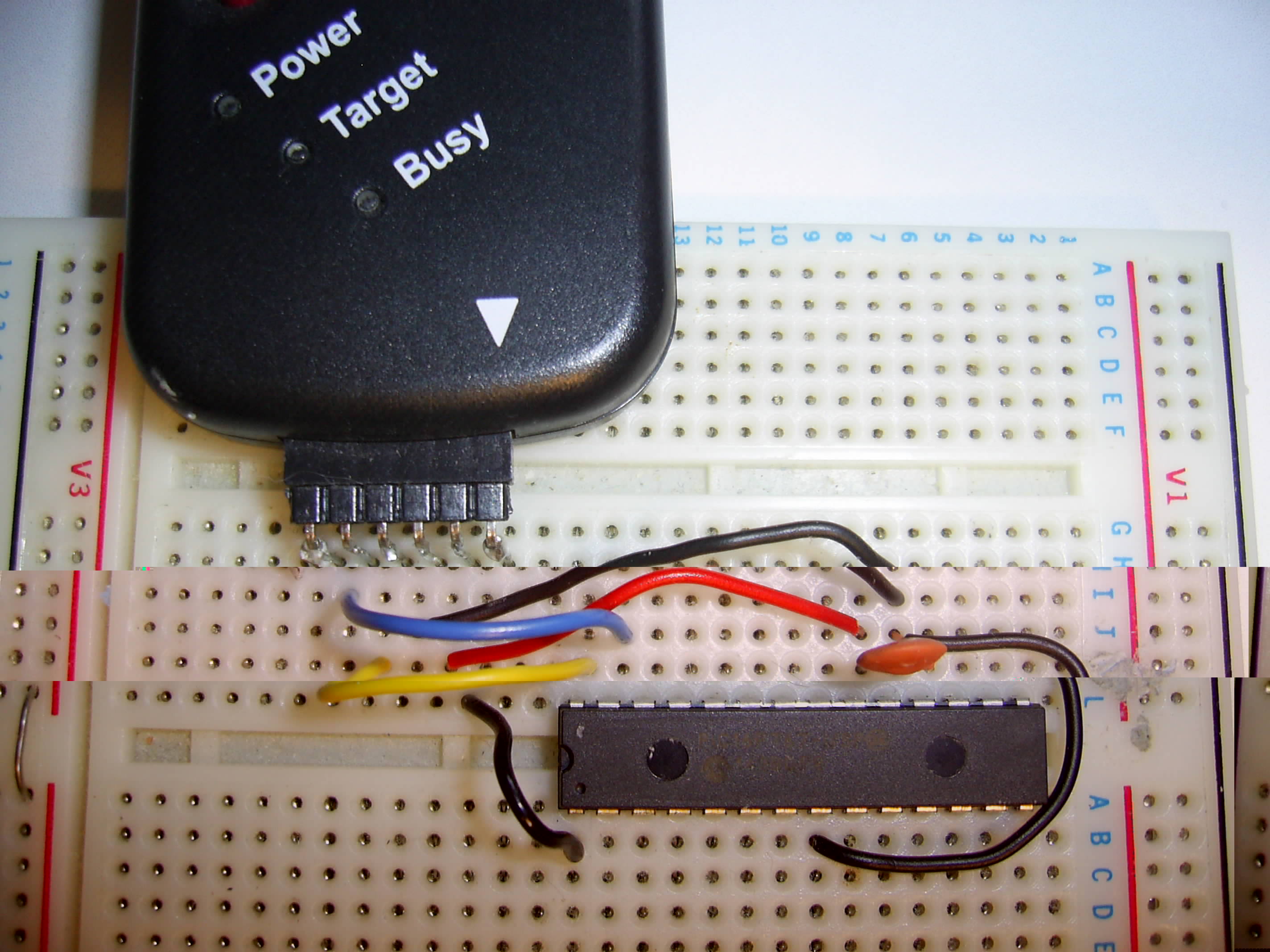

Hi, have inserted the circuitry for MCLR pin and tried to reprogram, LED came on but nothing further. Also tried disconnecting MCLR circuitry still nothing. Then changed MCLR pin to RC3 in the configuration settings still nothing.
I must be doing something wrong on the hardware side I think so I have attached a photo of my set up for your perusal. Its macro mode so it is rather large but easier to see.
Thanks guys...............John
