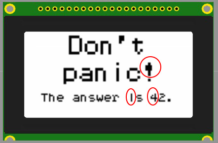

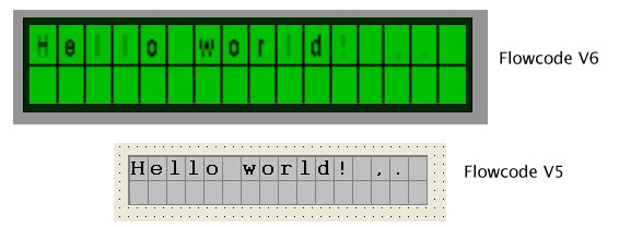

Hello!
Is it possible to turn off the smoothing on LCD ang gLCD? It's buggy in the simulation while in the HW looks good. Hard to debug in the simulator.

We fixed the bug with the alphanumeric LCD last week. I will get the other bugs you mentioned on the list. Many thanks.
I'll post the LCD fix here later today.
http://www.flowcode.co.uk/mmforums/viewt ... 54&t=17032
