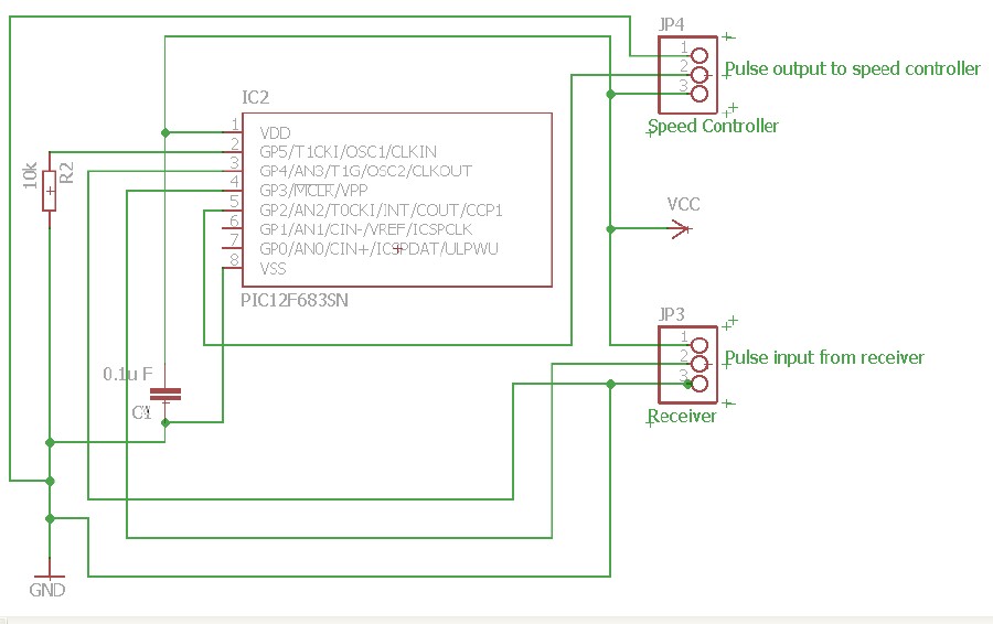

Re: Take off device for RC plane
Hi Martin,
Thanks again Martin of your great help for me!
I put in appendix a scheme in order to check that we both have understood this program in a same way. The switch was only to demonstrate those two states 50 % and 100 %. There aren’t such a switch only power on/off switch. My purpose was to to keep this simple only few other components not even a pot having a fixed delay. I tried to test this with Real Pic simulator but without any big success....
Can’t test this with hardware until next month.
Hope this helps.
jjw
Hope this helps.
jjw
- Take off timer.jpg (56.4 KiB) Viewed 14266 times
Hi Martin,
Tested the program with the hardware but without any success. Now I wonder how to check that pin 4 (input pulse from receiver) and pin 5 (pulse from speed controller) are in a program equal with my scheme above?
jjw
jjw
Hi jjw
Since you stated at the start:
So its MCLR = low, code not running.
MCLR high = code running so start at 50% then rise to 100 after a period of time elapsed.
If you want to change so a pulse triggers duty to 50 % then 100% it's a different design.
What I thought you was going to do from the initial spec is just have MCLR on internal. then connect receiver supply to microcontroller supply so both are powered up at the same time.
The thing is, the pulse input to MCLR has to go & stay high for this to work.jjw wrote:Tested the program with the hardware but without any success. Now I wonder how to check that pin 4 (input pulse from receiver) and pin 5 (pulse from speed controller)
This is no mention of a trigger pulse.jjw wrote:- when power is switched on during the next 6 seconds power is reduced into 50%.
- after 6 seconds the power should be 100%.
You wrote:
So any idea what to do?
jjw
I don’t exactly understand what do you mean with a different design. As far as I understand your comment is to add a pot with it can be reduced power from 50% to 100%.“If you want to change so a pulse triggers duty to 50 % then 100% it's a different design.”
Yes MCU and receiver will powered at the same time.”What I thought you was going to do from the initial spec is just have MCLR on internal. then connect receiver supply to microcontroller supply so both are powered up at the same time”
jjw
In that case you don'r require MCLR.
You can disable it and just connect PMW o/p to the speed controller.
When power is 1st applied to microcontroller duty will start at 50%, then goes to 100% after 6 seconds.
