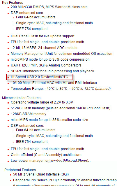

PIC32MZ supports Full speed USB QUAD SPI etc the EF family has Floating point units as some of the ARM families,secondly PIC32MZ supports also 200 MHZ clocks so I think
there is nothing that ARM can do which a PIC cannot do :D
Full speed USB runs at 12MHz and is the same as on the USB enabled 18F PICs.
High Speed USB runs at 480MHz.
Quite a big difference there :D
There is currently no PIC devices I'm aware of that support High Speed USB though if one became available I would be right on it :D
USB 3 runs into the GHz I wonder if/when we will see this available on a micro.

Ben my mistake It was type or not thinking error PIC32MZ does support High speed USB
if I am not mistaken :D
Re: Flowkit 2
Aha thanks for the info :D
I don't think these devices were available at the time we were designing the Flowkit 2 but they do certainly look interesting for future projects and products.
I'll see if I can get hold of a couple and have a play with them.
Though this note from the datasheet is a bit worrying as it sounds like the FS USB speed not HS. Hopefully the USB dedicated PLL allows you to go up to HS frequencies.
If the USB module is used, the Primary Oscillator (POSC) is limited to either 12 MHz or 24 MHz.
One thing I would say is they are not that cheap. Especially when compared to a like for like ST ARM. However looking forward to having a go.
