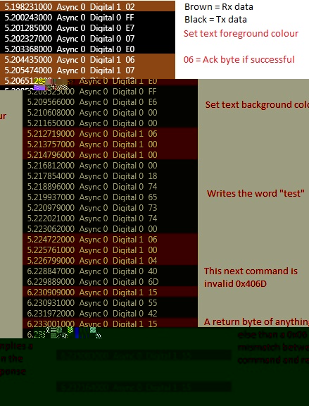

I wish i had looked at using the logic analyser sooner.
Using the EB076V1 component with the R22.Pmmc file for the display i have observed the following.
Using an 8 bit PIC the display functions ok with the baud rate set to high or low.
Using a 16 bit PIC at a high baud rate the display fails to recognise the command.
When running at a low baud rate the display would not work. However upon connecting the logic analyser the display would work. The operation of the display seems to work at times and at others not. This problem is not experienced when using the 8 bit PIC. I am not sure why i am getting these issues and whether there could be some possible hardware conflict. Some thing to experiment with.
Using the EB076V2 component with the R44.Pmmc file for the display i have observed the following.
With an 8 bit and 16 bit chip the results are the same
The program being run initialises the chip and the SD card then writes "test" on the screen. After this it is meant to access an image off the SD card and display it on the screen. However when it gets to this stage it sends out a command of 0x406D. This instuction is not a valid instruction. This is the old instruction used in the R22.Pmmc serial graphics controller instruction set using for the EB076V1 component.
With the R44.Pmmc serial interface used for the EB076V2 component, the instructions for displaying images from the SD card are different

As an extra point of interest, the display file R44.Pmmc (used by EB076V2 component) is the latest revision of firmware for these displays. The older version R22.Pmmc(used by EB076V1 component) is for the old serial graphics controller platform that has been superseded by 4D Systems newer serial programming environment. One clear advantage i can see from using the latest version is that it allows you to calibrate the touchscreen so its output is relative to the pixel co-ordinates where the touch occurred. Under the old version with a display resolution of say 480 x 272 i have found that the actual output from the touch screen is not relative to the pixel co-ordinates and this error becomes larger as you move down the display. For example if a touch occurred at x=470 the return value could be x=495. Just makes it easier for writing your code.
