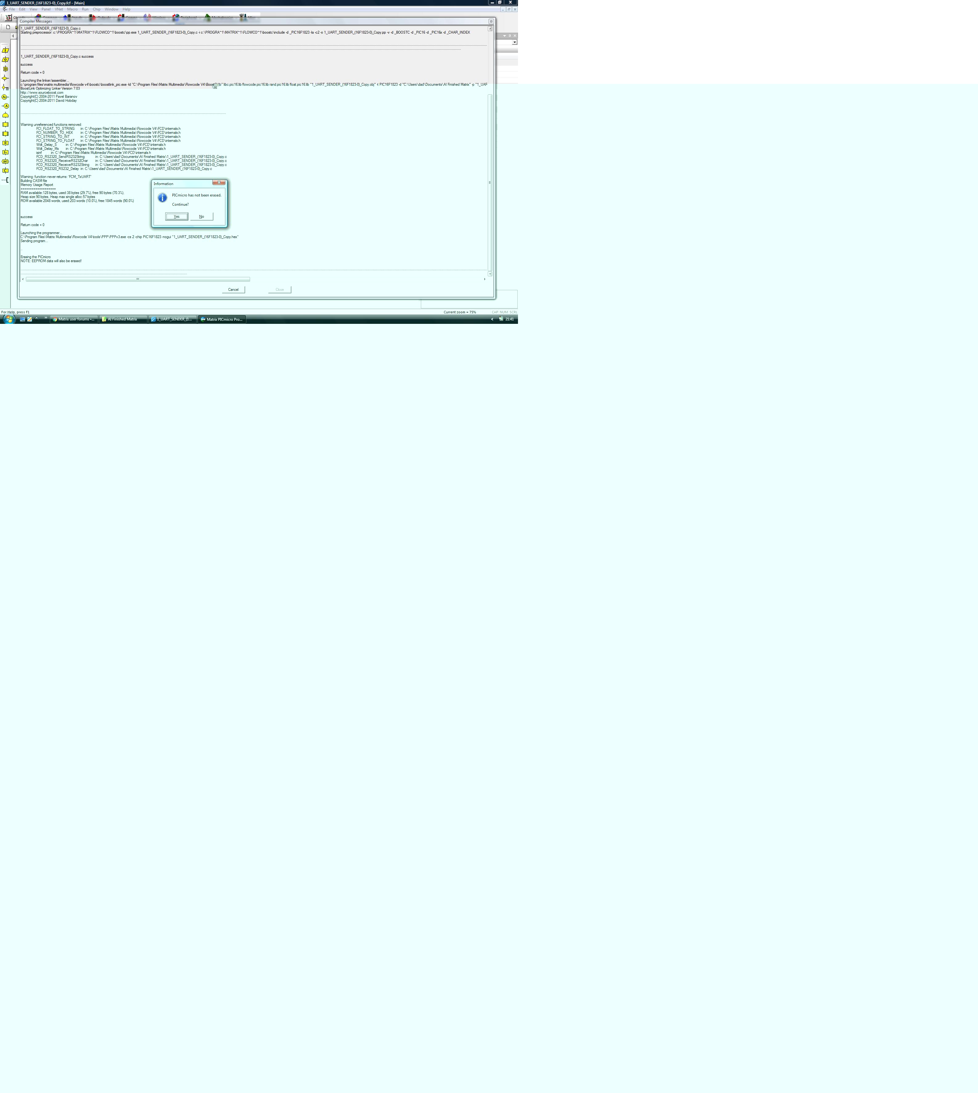

Hi Martin,
This is with PPP
(377.83 KiB) Downloaded 7554 times
Posts: 9521
Has thanked: 2585 times
Been thanked: 3815 times
Re: All good except not completing 'compile to chip'
Hi Chris,
PPP programmer location looks wrong.
There is a square bracket in your path after V4\.
You can select Restore Defaults.
Then make sure you have:
Programmer:
Location:C:\Program Files\Matrix Multimedia\Flowcode V4\tools\PPP\PPPv3.exe
Parameters:-cs 2 -chip PIC%p -nogui "%f.hex"
I have just programmed a 16F1824 with Flwocde V4, PPP and EB006 V7 which is prior to ghost so should be the same programming setup as your hardware.
If you make sure location and parameters are as above we can then take it from there.

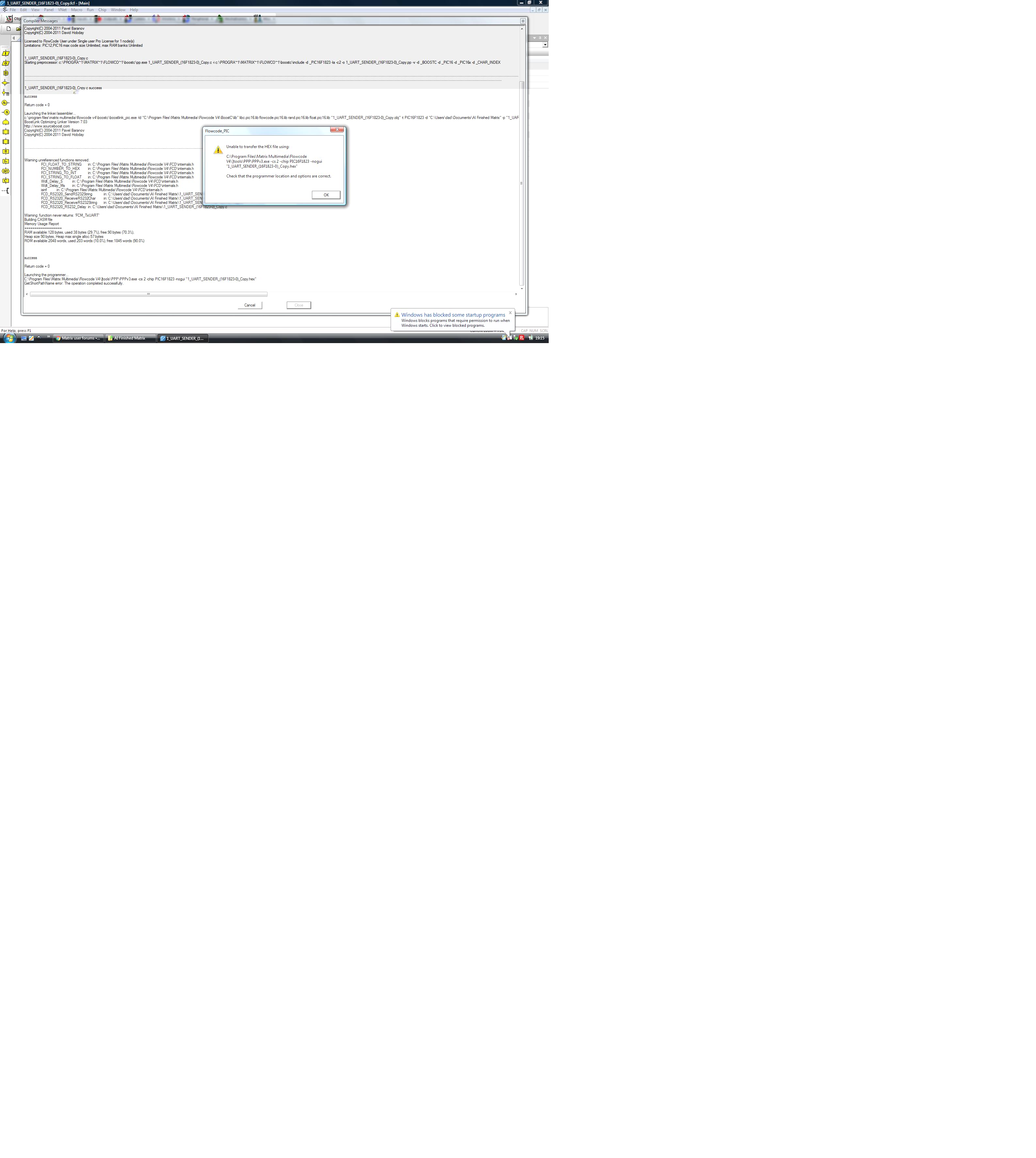

Post by christoph »
Hi Martin,
This is now how it looks and the dotted lines are still continuing so will send you this and click OK and send you the result (bearing in mind that I still have this problem of all my charts still taking 8 minutes instead of a few seconds)!
(365.78 KiB) Downloaded 7545 times

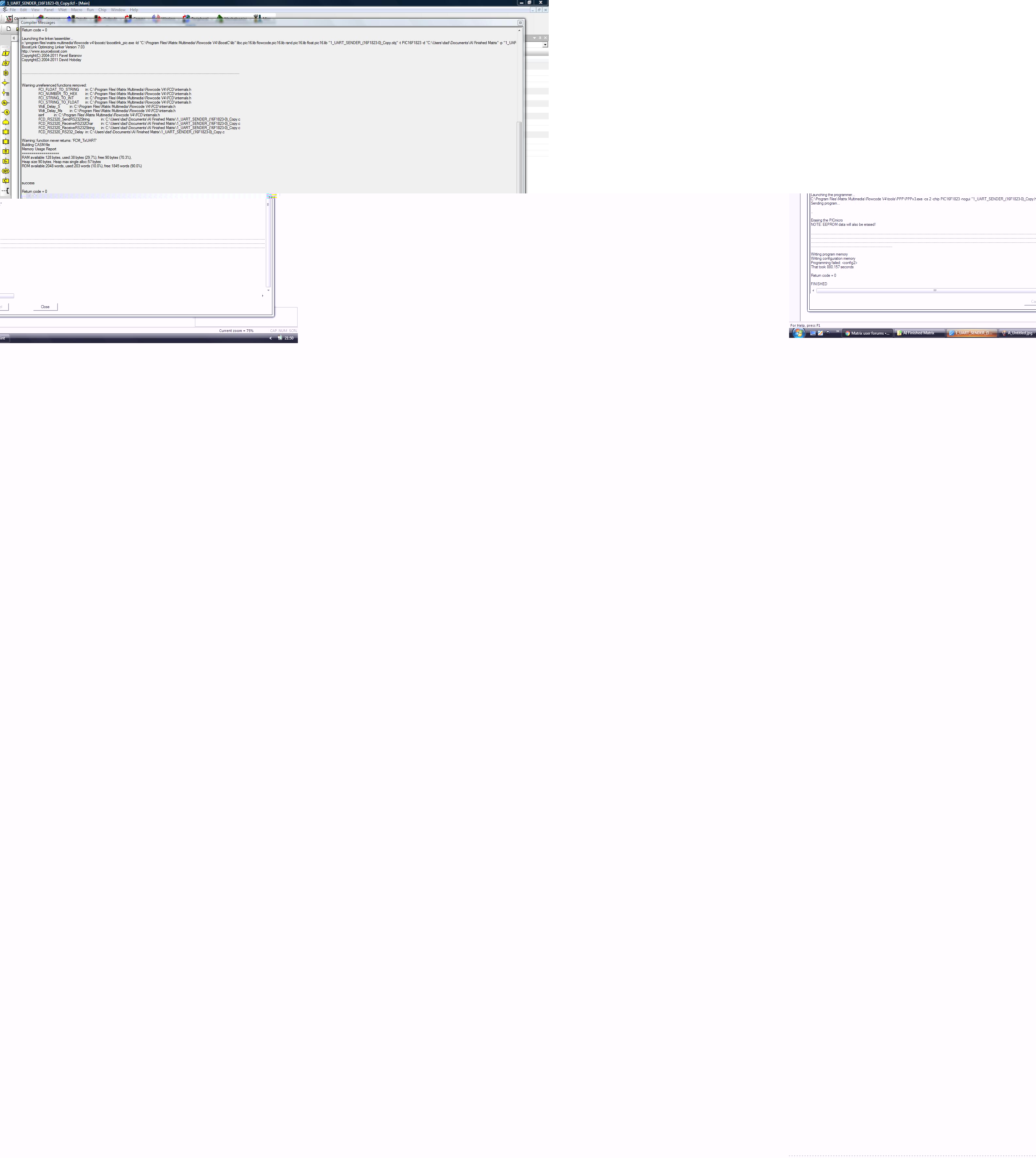

Post by christoph »
....and when I click 'Yes' it finishes like this:-
(344.59 KiB) Downloaded 7545 times

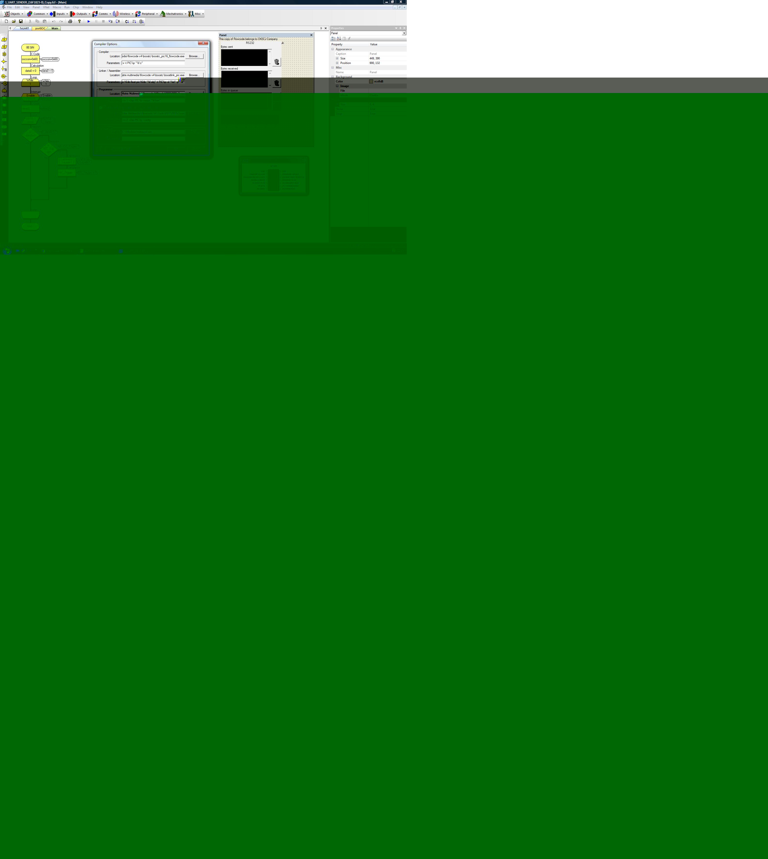

Post by christoph »
....and these are the current Compiler options (two 'cos I can't get the 'whole' lines to show) :-
(383.51 KiB) Downloaded 7544 times
(383.27 KiB) Downloaded 7544 times
Post by christoph »
Well spotted re the square bracket which was because when I DO select defaults, it comes up with a word ( I cant remember what it is and don't want to mess anything up at this stage to check) inside square brackets and way back a year or two, this problem came up and is fixed by replacing the square brackets and contents with what it should be at the start of the line - and I had inadvertently left the end bracket and not noticed. I explain this here for the benefit of anyone following this as well.
It is the long dotted lines that use up the 8 minutes processing and Task Manager shows that up as 'not responding' during that time. I am just concerned to try and get F1823 to programme as I havent been able to test the hardware yet. :(
