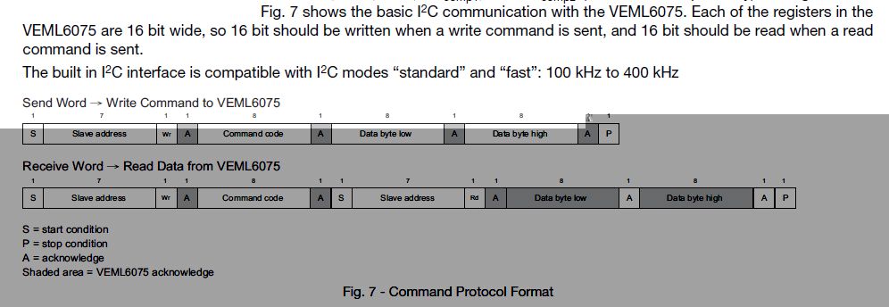

Please find my flowcode the measure the UV_B light intensity of an UV sensor VEML6075. It does not work correctly, which can be due to a Flowcode error or hardware. I found a C-code programm (attached) which I use as example for the Flowcode. The read and write I2C procedure for reading/writing a word is given in the picture.
