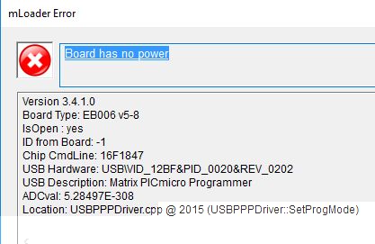

I get an error message that the board has no power. But I do not use the EB006 board, but the PICkit3. And the microchip has been powered separately. What to do? With kind regards
Jan Lichtenbelt
Jan Lichtenbelt

It looks like Flowcode is still trying to use mLoader to send your HEX file to the chip.
Martin's previous post shows a screenshot of the Compiler Options screen. Does your screen in Flowcode look exactly like this?
Regards,
Steve.
Regards,
Steve.
