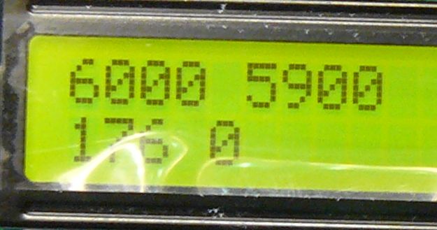

I try to calculate the percentage of A compared to B. In the simulation I get the right answer of 98%, but with the 16LF1847 completely wrong result.
Who is that possible. And what to do?

The calculation D = 100 * B is what is causing the problem.
If you instead change to this then it should work as expected.
D = B
D = D * 100
This forces the * 100 to be a 32-bit calculation.
If you use the PrintFormattedNumber function to print out the D variable then you will see the true 32-bit value on the LCD - 590000.
D = B
D = D * 100

Thanks a lot. It works.
Multiplying by a number ( eg. 100) is no problem if one uses Uint. But is seems that in case of Ulong the number has to be changed first into a Ulong variable.

Hi Jan,
One thing I have noticed.
If you want to display correct 590000 instead of 176 then instead of using LCD you can use .
Use 1 in the Bool input box for Unsigned number.
PrintNumberCode: Select all
PrintFormattedNumberUse 1 in the Bool input box for Unsigned number.

Yes, it's a "C" thing. It depends upon the size of an "int" on the platform/processor.Multiplying by a number ( eg. 100) is no problem if one uses Uint. But is seems that in case of Ulong the number has to be changed first into a Ulong variable.
So it isn't a problem on say ARM, which is 32 bit.
For interesting reading search "integer promotion"
