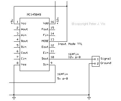

Ah, I see, I missed the fact that you are using an RC servo system.
You would need to use MIAC Inputs 1 and 2 as direct digital inputs with InputDIGITAL(),
only these two inputs connect directly to digital inputs on the processor.
The InputANALOG() will be too slow.
The next problem is that the RC receiver channel outputs will not be a high enough voltage,
so you will need to level shift from the RC logic level to the MIAC level,
something like this should do it ...
https://www.onsemi.com/pub/Collateral/MC14504B-D.PDF

I have now got the RC logic level to the MIAC.
The converted RC outputs 4V to 12V according to the oscilloscope. But in dsPIC. Type MI5809 does not show the correct ouput for display that should be 0- 255 bit
User RC-Servo Test: Result shown in display from dsPIC .Type MI5809.
See ouput below: By from RC servo is 800 til 2200 Pulse
Has attached the FlowCodes below:
