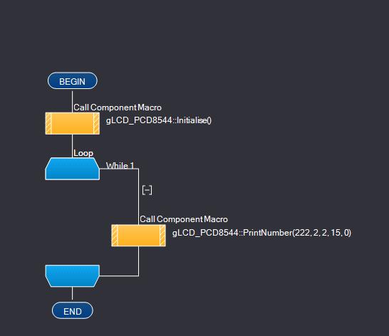

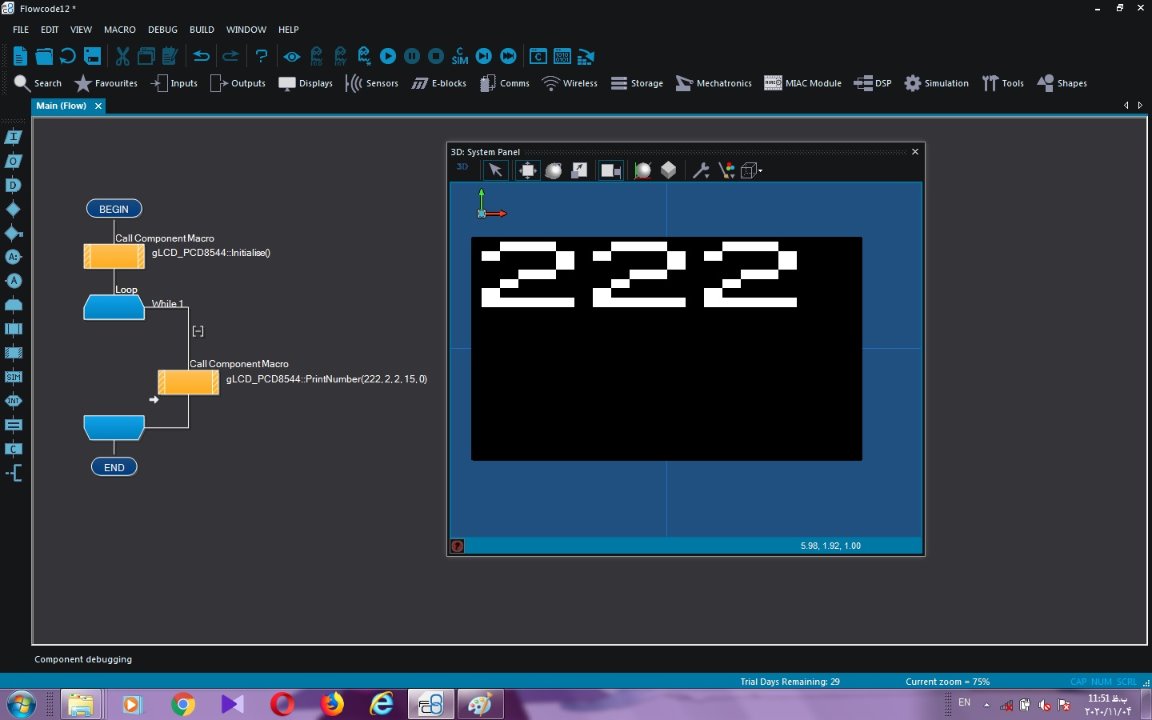

Re: Nokia5110
hey
ben i have a problem with the 5110 LCd it s not showing the charecters just showing some lines
i have simulated it on fc8 it works perfect
but in reality its just showing lines as i said before, i used ardiuno uno and fc8
thanks in advanced
thanks in advanced
- 1.JPG (15.27 KiB) Viewed 8522 times
- qwqwqw.jpg (78.49 KiB) Viewed 8522 times
mnf
- Posts: 1208
- Has thanked: 70 times
- Been thanked: 440 times
Re: Nokia5110
Just an idea - but your code is constantly re-writing the number on the display. Try adding a delay to the loop, or just write the data once and get rid of the loop.
Re: Nokia5110
yea i tried it but it dident work
there are no other idea ? can you send me the chart that you say ?
