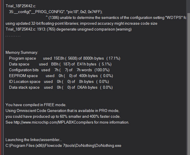

Re: 18F25K80 AND 18F24K22 MODBUS SLAVE PROBLEM
your 18F25K42 compile fine with me in FC 7
see screen printbelow
Did you install the latest updates for FC 7 from here
http://www.flowcode.co.uk/mmforums/viewt ... 63&t=19743

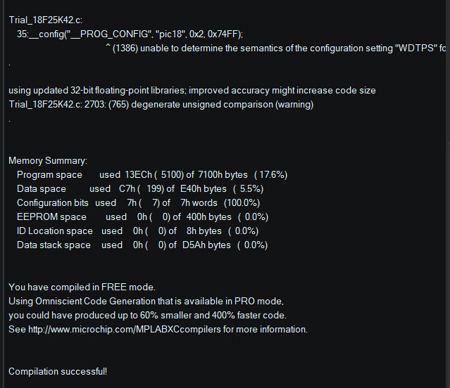

HI
Ok you posted in the FC 7 forum please post in the FC8 forum next time around
Your code (FC chart) compile fine for me in FC8 V8.1
Please update to FC V8.1 and try again

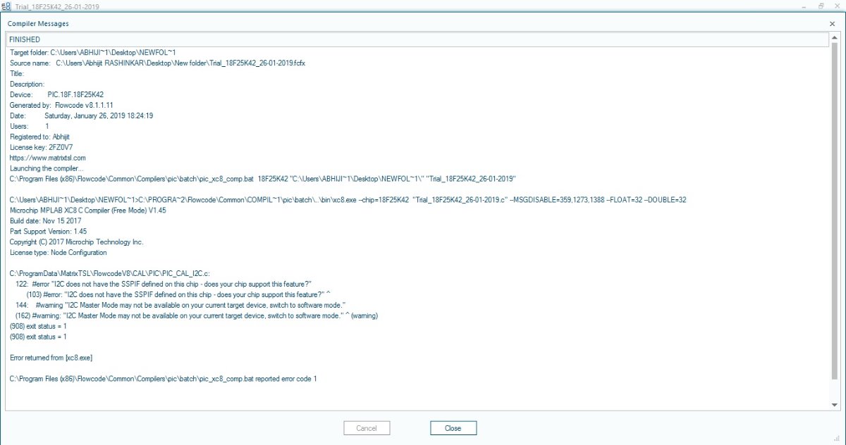

Kindly excuse for the delayed reply, following your previous post, I uninstalled the FC8, downloaded/installed the FC8.1 and again tried to compile but unfortunately the same error, may I request you to check the properties I have set for the Display as well Modbus and Project Option too.
One more thing I observed, when I select the device PIC18F25K42, the I2C and UART, receives additional pins to select from the drop down menu in the properties window, I think something goes wrong over there, but I do not understand where and why.
Thank you, hear you soon.
Abhi

- Compiler_Message_26-01-2019.jpg (80.07 KiB) Viewed 21206 times

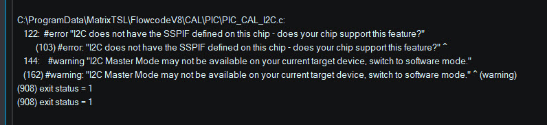

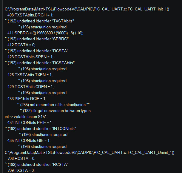

I checked your flowchart and to me there is a configuration/definition error for the chip in Flowcode (cal components).
The team will solve this for you or Martin
@Team
below the compiler errors with MODBUS not active only LCD then the I2C errors are shown second time around gLCD not Active MODBUS
errors caused some strange reports
@Team
The topic is a bit strange. It details the k80 devices and K22 devices but reading the text the problem is with a k42 device. Looks like it's maybe a hijacked topic.
Anyway looking at the K42 device datasheet it looks like the registers for I2C/SPI etc have been completely re-done so we will have to spend some time re-working the FCD and CAL to suit. Do the K22 and K80 devices have similar issues?
I'll try and get on with this later this week, for now you might want to use a different device if that is an option.
