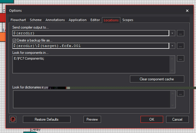

Please Note!
Do not store this component in your main FC7 component folder. I would recommend you save the component somewhere else and use the 'Global Options' under the 'View' menu to set where FC7 should look for your components as shown here:
Global Options.jpg (142.29 KiB) Viewed 13040 times
Better than messing things up just yet.
Dave

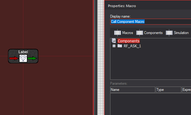

I give up. Just cannot figure out how to get a 2D model/image to go with this component I have created. Nothing works, like using 'Shapes'; 'images' etc. I cannot find any help files to explain what I am supposed to do. Your 2D models, when loading your components look cool. What I get, at best, is a dot, so small is pointless.
please could you indicate if there is a bug or what I might be doing wrong.
Here is the icon - display OK
(44.82 KiB) Downloaded 7275 times
But the model, well!
(21.44 KiB) Downloaded 7275 times
Help!
Dave

You are a star. It works. Thank you ever so much. Question is though for another day - why, and what was I doing that prevented my images from working?
Here it is:
New Component.jpg (79.04 KiB) Viewed 12967 times
Well, now that I have a working component image that shows my component, brilliant, All I need to do now, is figure out how to get the simulation LED's to work. I wouldn't have much time to do that today, so I may be bothering someone later with more questions. Hope you don't mind?
Thanks a lot.
Dave
