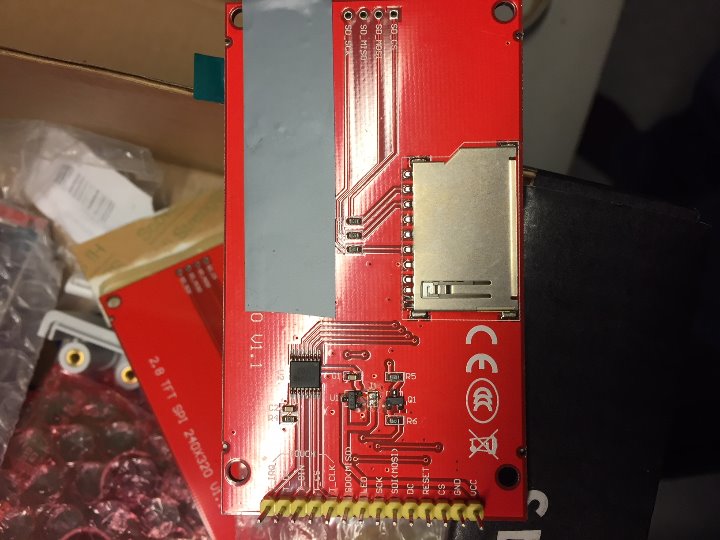

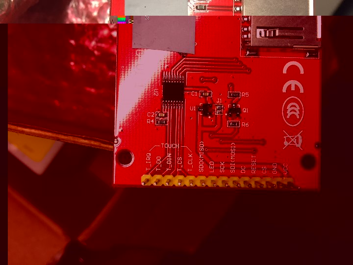

I bougth the display on ebay, And I have no further data on this. http://www.ebay.com/itm/2-8-TFT-LCD-Dis ... 2749.l2649
I have orderd a couble of new so I am sure it not is the display which is wrong... but If you find something wrong with the component, and male some correction, Ill test it again.....
I seem to be the same as Bachman use
You create a componet for Bachmann in FC6 here: viewtopic.php?f=59&t=17317&hilit=ili Maybe this tell you something---
You Help me with the the Nokia 5110 display and it work fine and I use it. But it could be nice with some color on the screen
Br Jorgen

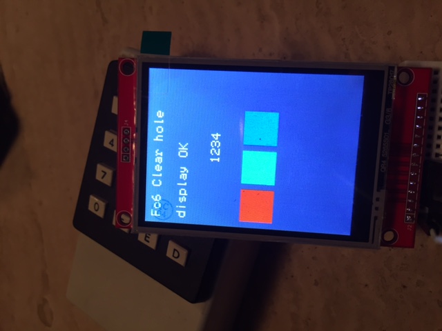

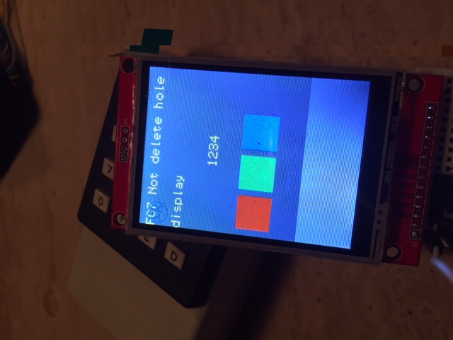

During my troubleshooting with the Ili9341 display, I made some test, to ensure it not is my display´s which is defective. You have made some modification here for the ILI9341 in FC6: viewtopic.php?f=59&t=17317&p=73847&hilit=ili#p73847
I tryed to get your corrected file (FC6) and placed it in FC6 directory. Tested it with FC6 and Mr Tido´s program with an Eico40. Working. Test with 2,4` and 2,8`. Both succes.
But I almost try everything with Arduino Mega in FC7, I can not managed to get it working not working in FC7 with Arduino. Do you have any idea what could be wrong, please.
Br. Jorgen

But the only `bug`now is that, when I use Clear display in FC7, not the hole display is cleared (Arduino ? But it in FC6 I clear hole display (Arduino). Look at att. picture.

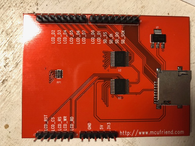

I want to use the GLCD_ILI9341 with an UNO. The downloadable file below, labeled "ILIDisplay Test", uses an Arduino MEGA.
The connections for the MEGA are MOSI,Clock,Chip Select,D/C.Reset,LED.
I am wondering what the connections are for the UNO. The default pins for n UNO are: MOSI is B3,Clock is B5, not sure what Chip Select is, unless is is a digital output, Not sure what D/C or Reset or LED are.
- 2.4" touchscreen and display
- mcyfriend.com.JPG (130.39 KiB) Viewed 14772 times

Hereby, as promised, picture of pinconnection on my display´s
Br Jorgen
Br Jorgen
- IMG_0548.JPG (70.62 KiB) Viewed 14657 times
- IMG_0547.JPG (71.75 KiB) Viewed 14657 times
