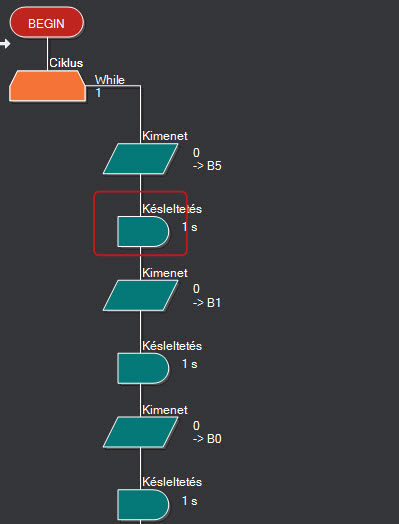

Hi All,
I would like to ask for help.
I have a CURIOSITY PIC32 MZ EF development board with PIC32MZ2048EFM100 processor.
Unfortunately, I can not start the simulation of flowchart with this processor.
I tried on two computers (WIN7 64bit HUN on both machines).
On one of two computer, if I click on the simulation launch icon, then Flowcode7 crashed. (I get a Windows message: Flowcode V7 Operation Stopped)
If I press the F5 key for start the simulation then nothing happens.
For the Flowcode V7 running on another computer, the simulation can not be started.
(I can not start the simulation either with F5 and Start icon, but the Flowcode is running, do not stopped. )
I use Flowcode v7.2.0.5 and Flowcode_7_Latest_170717 files.
The simulation is working well for 8-bit and 16-bit processors.
Thank you in advance for your help.
Lagoda
PIC32MZ_test.fcfx
(6.4 KiB) Downloaded 543 times

For what it is worth your Flowchart runs fine with me in FC7 and WIN10 .

Lagoda

Runs OK on my Windows 7 (64bit) too
The current version is Flowcode v7.2.1.4, I think you should update it.
After the upgrade, add the repair package.
Windows7 prof. 64bit HUN works perfectly for simulation.
Mr. LeighM will support this developer circuit?
I think this card has internal programming hardware.
How to use it? Or should PicKit3 be programmed?

Hello Tibor,
Yes, that was the problem.
For the board has an ICSP Header connector.
I use PICKIT3 programmer for the programming.
Thanks for the help.
