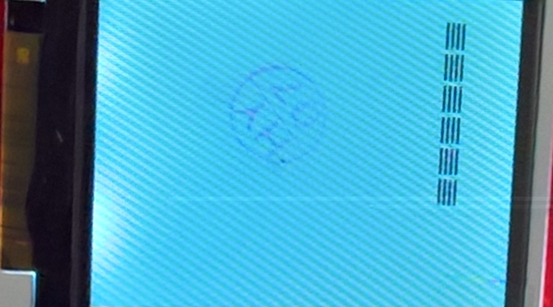

I am having trouble getting this display to produce text correctly. I have a working project which uses this display - equivalent to the EBM001. Everything worked well pre March 2017 build 7.1.1.0.
However, with the latest FC7 build (7.2.1.4) I cannot get this LCD to display text - just a repeating pattern of dashed lines of the correct text length, everything else - graphics works OK. I thought I had corrupted the files, so I uninstalled FC7 - deleted all folders - reinstalled FC, same problem.
Tested the display with the chip using the HEX file produced pre March - everything works OK.
There is either a problem on my computer I cannot identify or this component has a bug, which has just been introduced with the latest updates.
Does anyone else have this display who may be having the same problem?

Here is the simple "Hello" project: Here is a photo of the results produced: I think I have screwed things up a bit!

I have found the problem is with my EB006-30-V9 board. I have produced a hex file using FC7 and programed the chip using PICKIT 3, everything is working OK. Is it possible to correct the fault with the board?

Yes, you are correct. The HEX file does contain all of the character ROM data, produced by FC7. When the HEX file is sent using the Pickit 3 - works OK. However, when the same HEX data is sent by the EB006 V9 (using the program via HEX file) - the ROM data is not sent for the remaining ROM address - 7E1C to 7FFE. This is strange, which to me, the mLoader is not sending the last ROM addresses. I will try and identify why and keep you posted.
