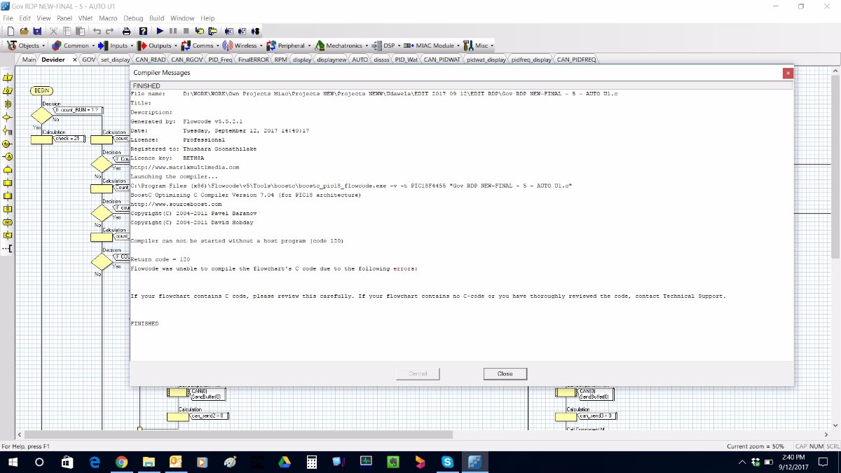

I have been working with Flowcode 5 since a long time back. But today when i try to compile a project then the below message comes and the compiling was hold.
'Compiler can not be started without a host program (code 120)'
I tried with my several projects which have been compiled previously. But anyone cannot be compiled now and the same message comes.
So please advise me on this. the message screen is attached for your reference.

Hi Thushara,
Try Rebooting PC first.
If that does not work, then go in to compile options via Build menu and select default.
If that does not work, you could re-install or use the repair option.
To use repair option you need to go to program and features within control panel.
Select Flowcode V5 then The Repair option will appear.
