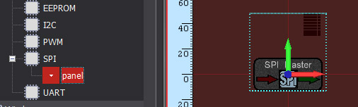

1. The simulation icon when used to build an exported component is an important step. You are seeing what I first thought when I started building components. This is what your component looks like so far when exported. I have set your component to 'Inherit' macros from the base cal_spi component. It'll illustrate what I mean.
Panel_SPI component.jpg (40.67 KiB) Viewed 79925 times
Everything is hidden and wrapped up in the exported component in a GUI image; connection pins; functional logic - everything.
So what you see when finished is very different when looking at your component project before it is exported.

Property copying is notoriously difficult.
So I suggest that you remove the Ev_Property code and "Expose" the SPI CAL properties directly into your component instead.
To do this, simple click on the SPI property (such as the Prescaler) and then select "Expose".
The (SPI) property will now be visible on the component property list.

Thanks Leigh,
Changed to exporting the CAL_SPI properties.
