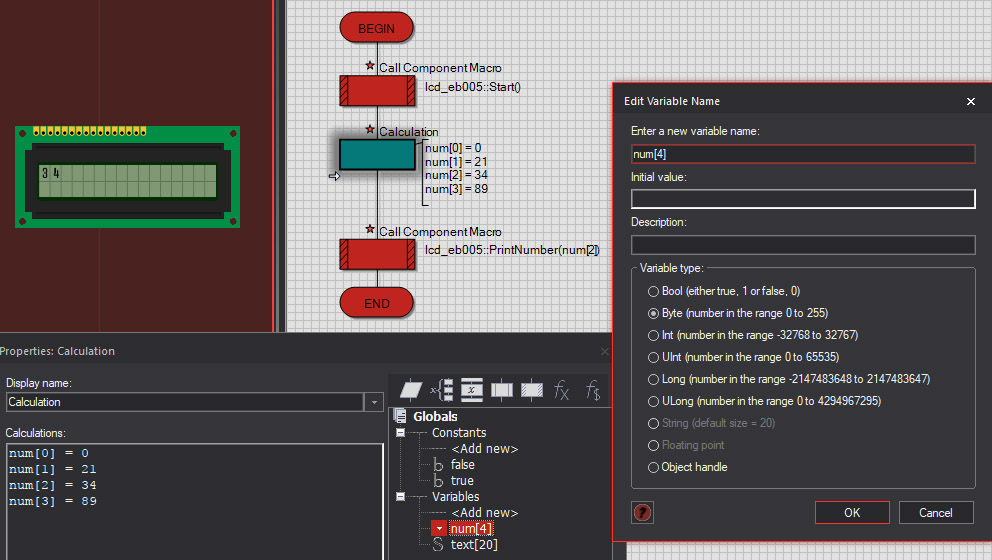

The way I understand the way to set up an array is as follows:
When the variable is declared, I place the size of the array using [ ] as you have within the set up box shown above.
Each value can then be defined using the calculation icon.
Hope this helps.
Dave
